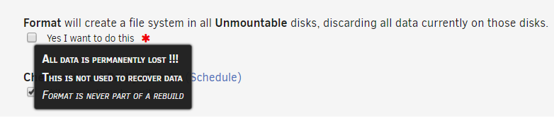

4 hours ago, johnnie.black said:
Formatting is never part of a rebuild, there's a warning that all data will be lost:
Only option to try and recover the data from the formatted disk is using a file recovery util like UFS explorer.
As for the other disk, there's filesystem corruption, run xfs_repair:
https://wiki.unraid.net/Check_Disk_Filesystems#Drives_formatted_with_XFS
I don't hold out much hope for this helping, but maybe, just possibly, change the wording of the message?
Current: Format will create a file system in all Unmountable disks, discarding all data currently on those disks.
Proposed: Format will create a file system in all Unmountable disks, discarding all data emulated by parity or on the physical disks.
There's already a change for v6.7, where it mentions "format is never part of a rebuild", but I bet i will still keep happening, your proposed change is also good, though not sure if would be better, if a user doesn't get that formatting a disk updates parity...
I honestly still think my idea of removing the format option from the main GUI altogether is the best idea.
If the only place to format the disk is on the disk page itself, it can be placed AFTER the file system check tools, and offered on a per disk basis instead of shotgunning the entire array and formatting everything that's unmountable.
Tracking the mountable state of a disk slot from one session to the next would help too, if the disk slot was mountable in a previous boot, maybe don't even offer a format option without passing through a disk check page.
If the format is a small sub option on the disk properties page, it can be linked with a more comprehensive explanation, and maybe require typing something in a confirmation box.
In my opinion, this "feature" of unraid is responsible for more data loss than any other, and deserves more attention.
IMO these are all good ideas, is there a feature request about this? If not you should create one so we could discuss this further and so it would be more visible for other users to also make suggestions.
Discussed to death a year and a half ago, no traction except for the addition of the warning checkbox.
Well, let's see if the new improved warning makes any difference:
If not, we can always revive that feature request.
