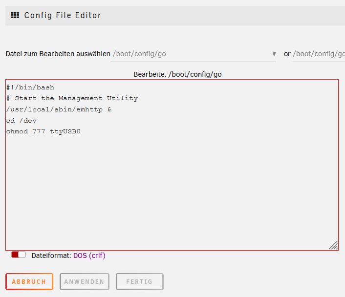

OK, works for me as well by executing the "chmod 777 ttyUSB0" command. Tx for that hint.
Anyhow, how to edit the "/boot/config/go." file ???? May I missed that info somehwere so even a link to educate myself would be helpful
You could install the Config File editor plugin.
As always, if u know how, it´s soooo easy.
TX
