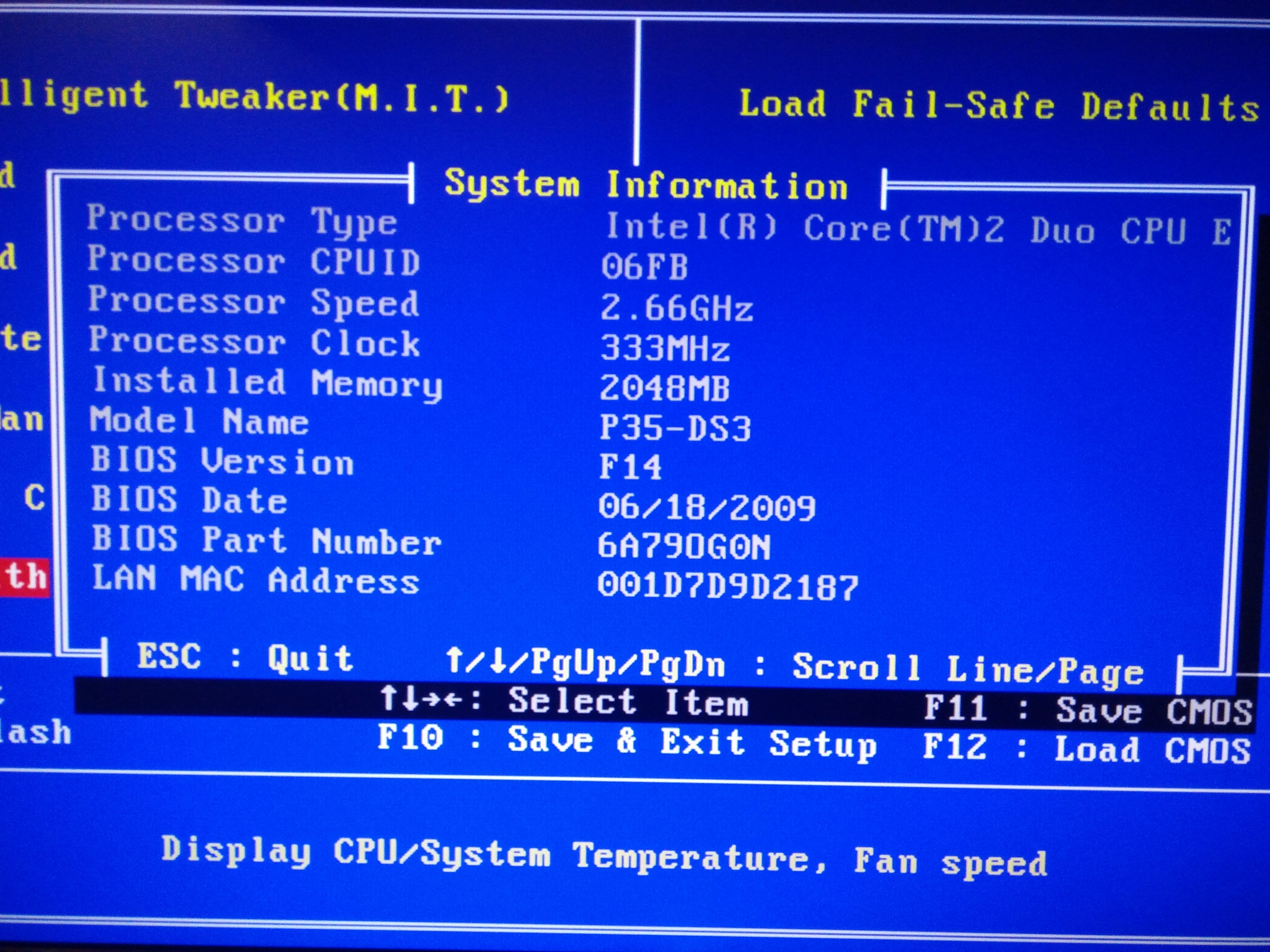

My motherboard is quite old and it is gigabyte ga-p35-ds3

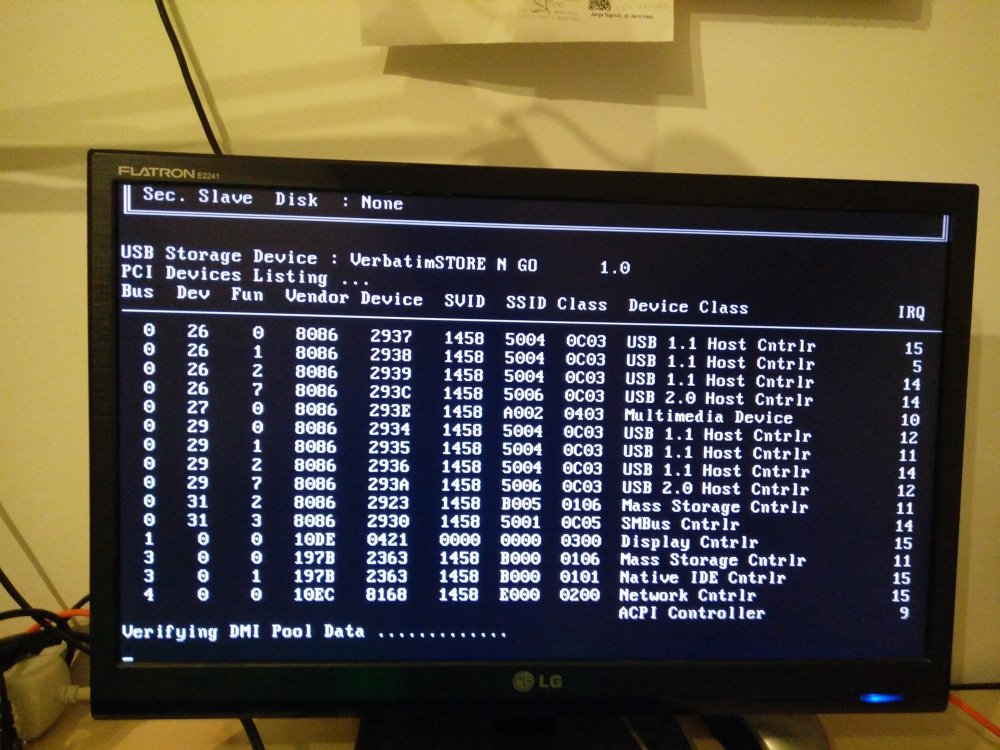

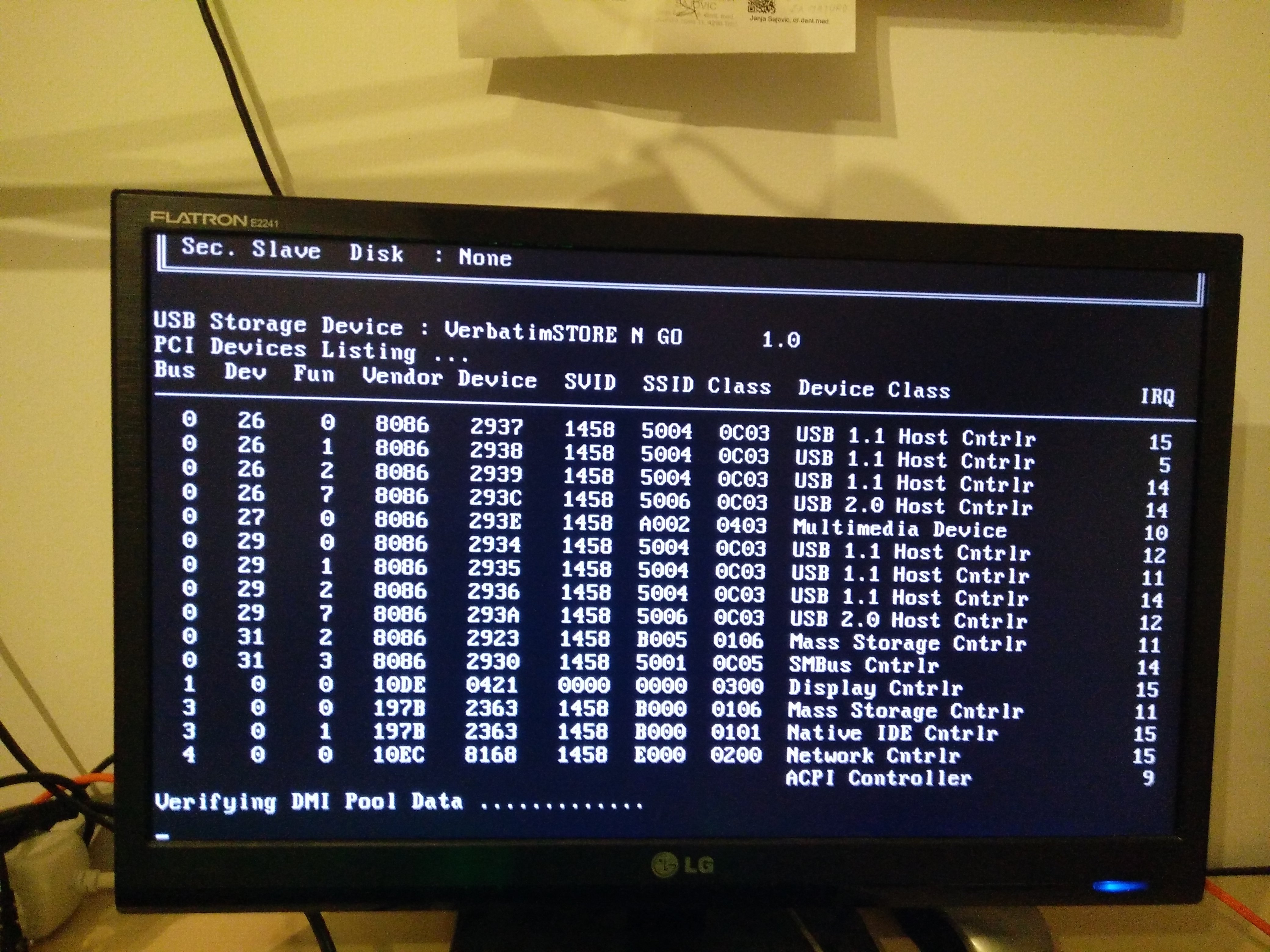

Yes I do it like you discribed. But if usb is in FAR32 it doesn't show up under hard drives and If the usb is in NTFS it does show up under hard drives.
Then try as First boot device either USB-FDD, USB-ZIP, USB-CDROM, USB-HDD,
I tried usb fat32 and set in bios boot from usb-fdd, usb-zip, usb-cdrom, usb-hdd and it didn't work. It stops hire.

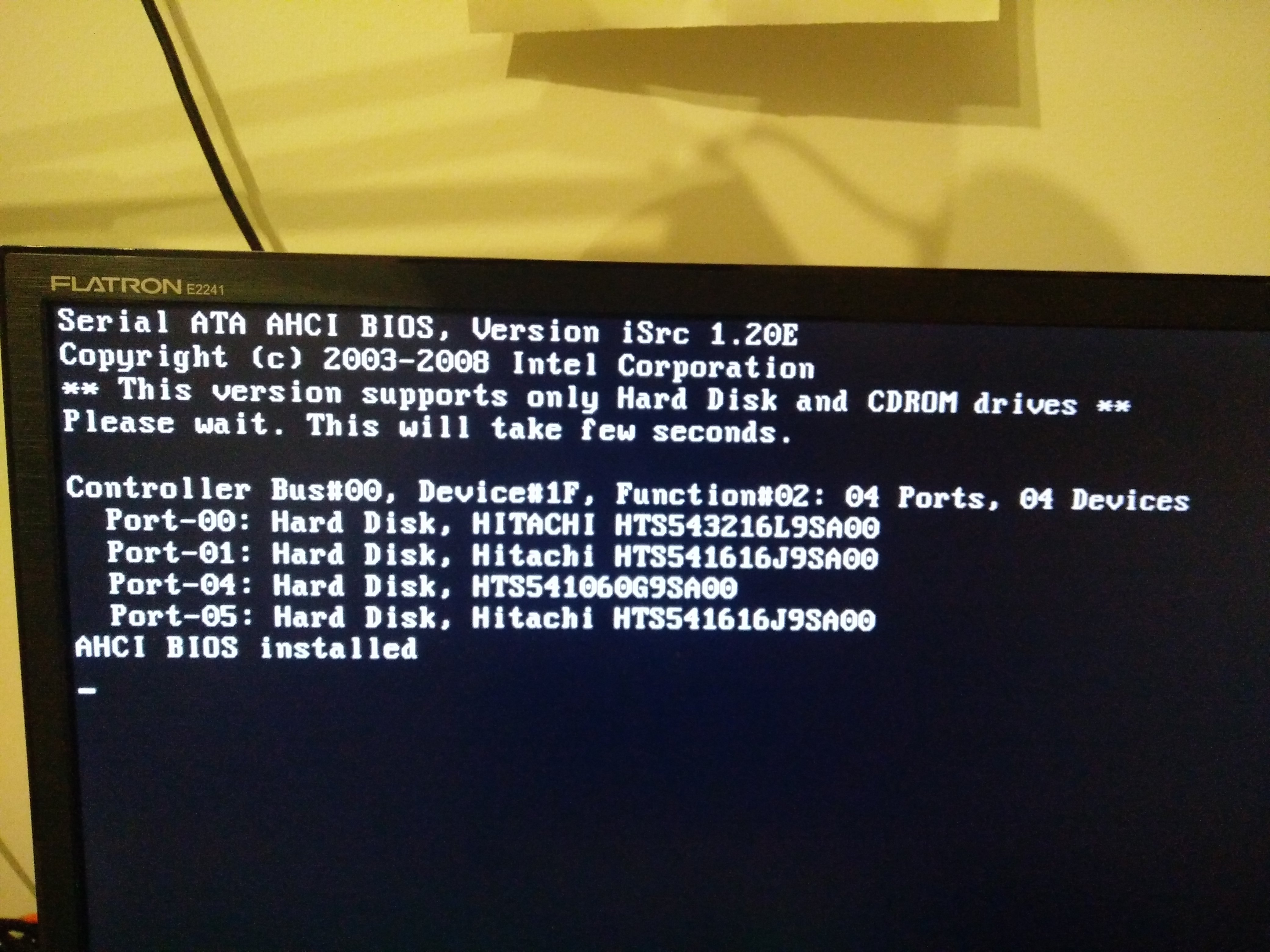

Now I realised when pc starts and checks sata ports the third line says it only supports hdd and cdrom. Is this an issue?

One thing I will say, pretty sure Unraid requires 4GB of RAM, and you're only rocking 2GB.  So you may want to evaluate how much effort you put into this endeavour.
You should be able to run Unraid on 2GB RAM if you do not intend to use VMs or Docker containers.    Note, however, that trying to update Unraid via the GUI is likely to fail if you 0nly have 2GB RAM.    In such a case the manual upgrade process needs to be used.
