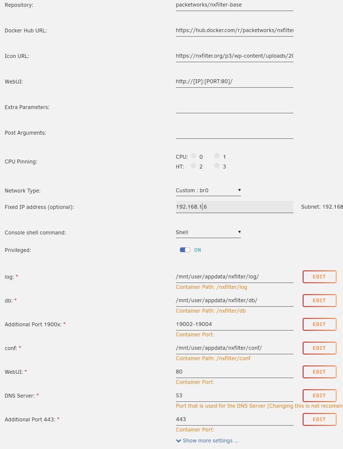

steps that I took:
0. Stop AdGuard, stopped docker and restart the docker without AdGuard auto start.
1. in console,
docker pull packetworks/nxfilter-base
2. create a container (see screenshot)

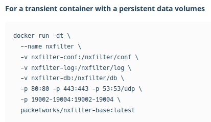

I set port 53 to UDP. All other ports are TCP.
according to this instruction.
https://hub.docker.com/r/packetworks/nxfilter-base

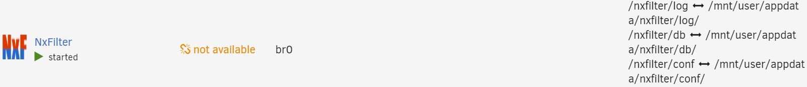

3. the container creation was successful but, there is no IP mapping.
docker run -d --name='NxFilter' --net='br0' --ip='192.168.1.6' --privileged=true -e TZ="America/####" -e HOST_OS="Unraid" -v '/mnt/user/appdata/nxfilter/log/':'/nxfilter/log':'rw' -v '/mnt/user/appdata/nxfilter/db/':'/nxfilter/db':'rw' -v '/mnt/user/appdata/nxfilter/conf/':'/nxfilter/conf':'rw' 'packetworks/nxfilter-base'

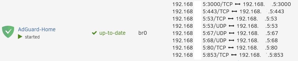

no IP and port mapping.
AdGuard shows the correct port mapping
I have only one physical ethernet port on motherboard.
I previously get AdGuard (from Unraid APP) working properly by setting fixed IP to 192.168.1.5.
