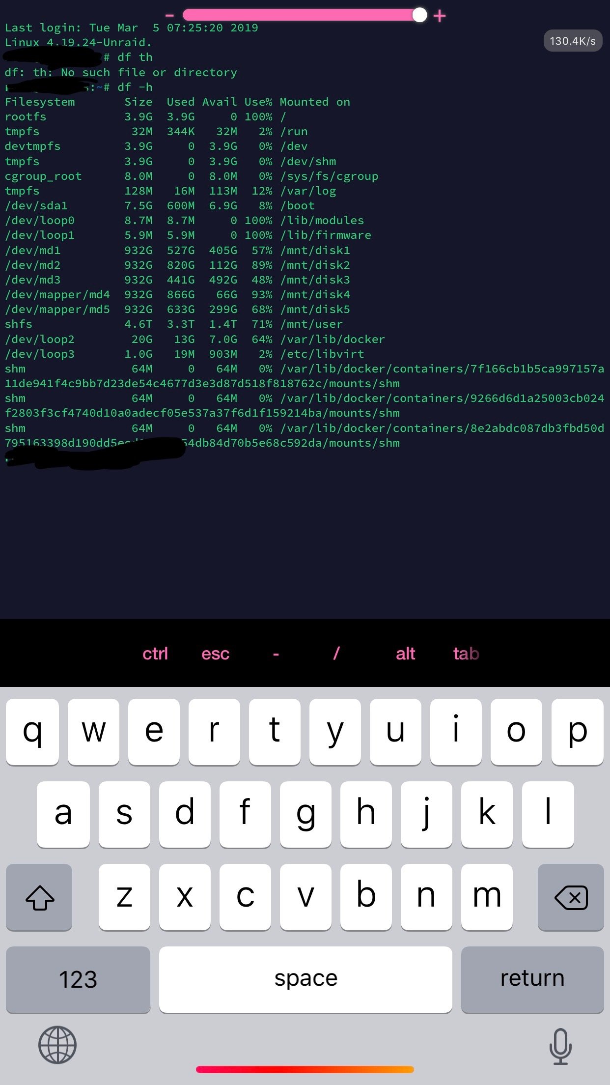

Also, I noticed the rootfs is full, I think this is what caused it,but why was it full in the first place?(It will go back to normal once I reboot.)
Yes this is definitely going to cause lots of problems. My guess is you have some docker volume mapping misconfigured so it is writing to the OS (which is in RAM) instead of to mounted storage.
