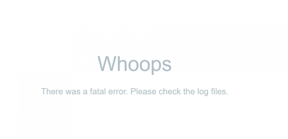

i have just figured out an issue on the new version of firefly 5.0.5
if you are getting a error in your log that looks like this:
local.ERROR: SQLSTATE[08006] [7] received invalid response to SSL negotiation: t (SQL: select "id", "name", "data" from "configuration" where "name" = is_demo_site and "configuration"."deleted_at" is null limit 1) {"exception":"[object] (Illuminate\\Database\\QueryException(code: 7): SQLSTATE[08006] [7] received invalid response to SSL negotiation: t (SQL: select \"id\", \"name\", \"data\" from \"configuration\" where \"name\" = is_demo_site and \"configuration\".\"deleted_at\" is null limit 1) at /var/www/firefly-iii/vendor/laravel/framework/src/Illuminate/Database/Connection.php:669)
and the web ui shows:
then you need to set a new variable in your container that looks like this

Hi There. I have set up Firefly III using the template from jc5x/firefly-iii. I have connected the mysql DB (after adding the additional DB_CONNECTION var) and I can see in the log that everything gets created as expected. however when I try to load the Webpage I get a "Whoops: Fatal Error".
 This is my first time setting up and using firefly - I appreciate your help.

Exactly the same here.
Is there someone who knows how to fix this?

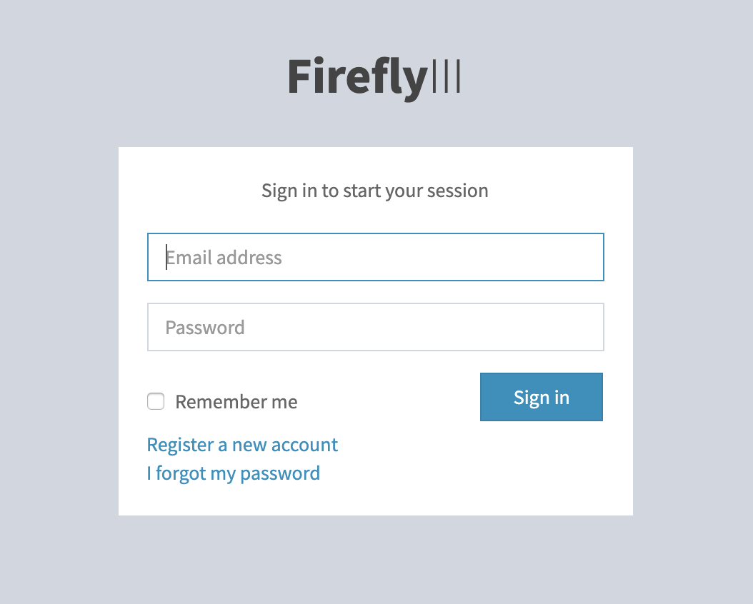

now I can reach my service both with my unraidIP+port 5080 and via my domainname firefly.mydomain.somthing but I can only register + login via unraidIP. When I connect via mydomain; I get the login page, but nothing happens after clicking the Sign In button......
EDIT//// Solved it: add another variable TRUSTED_PROXIES =**
