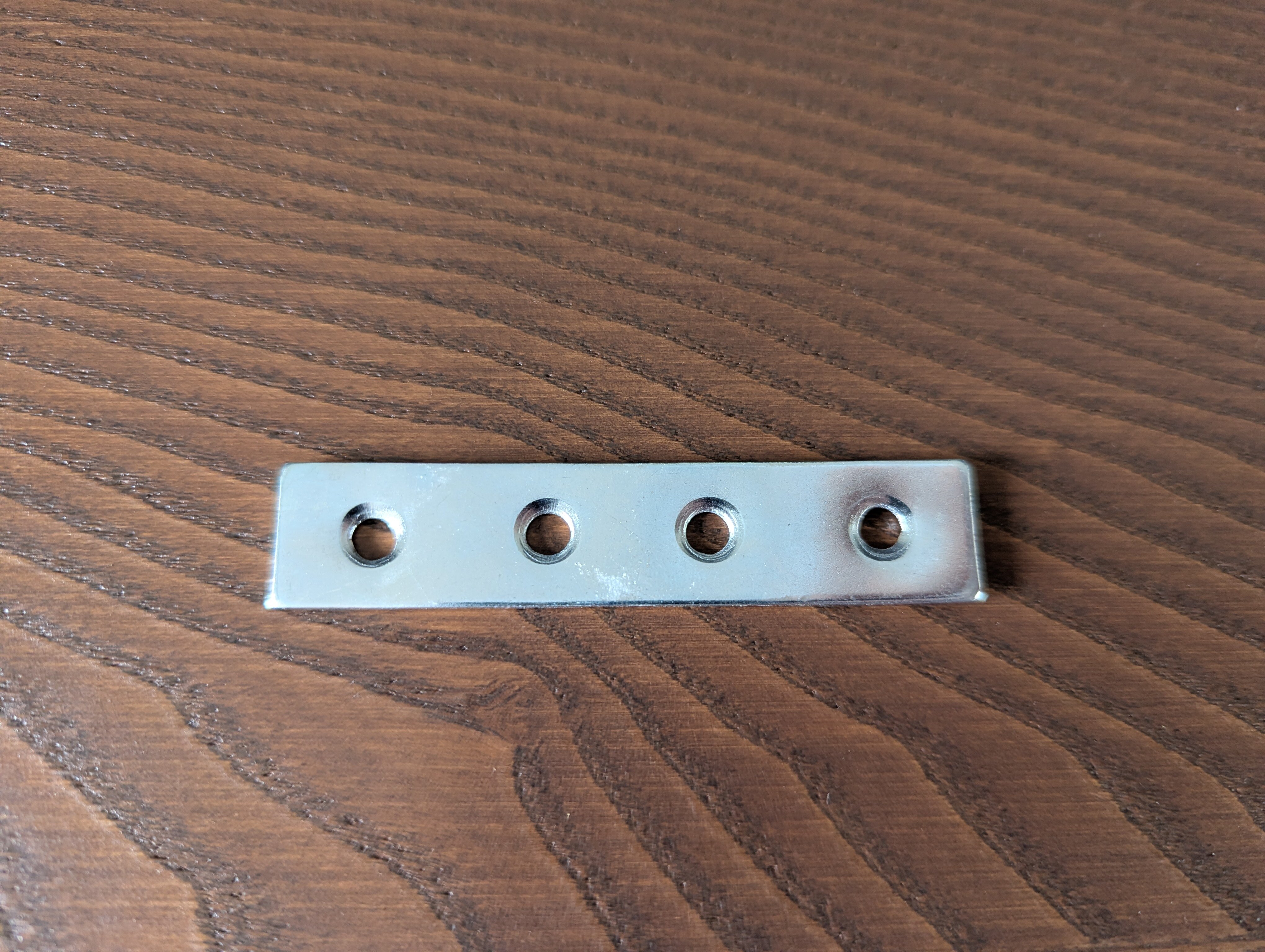

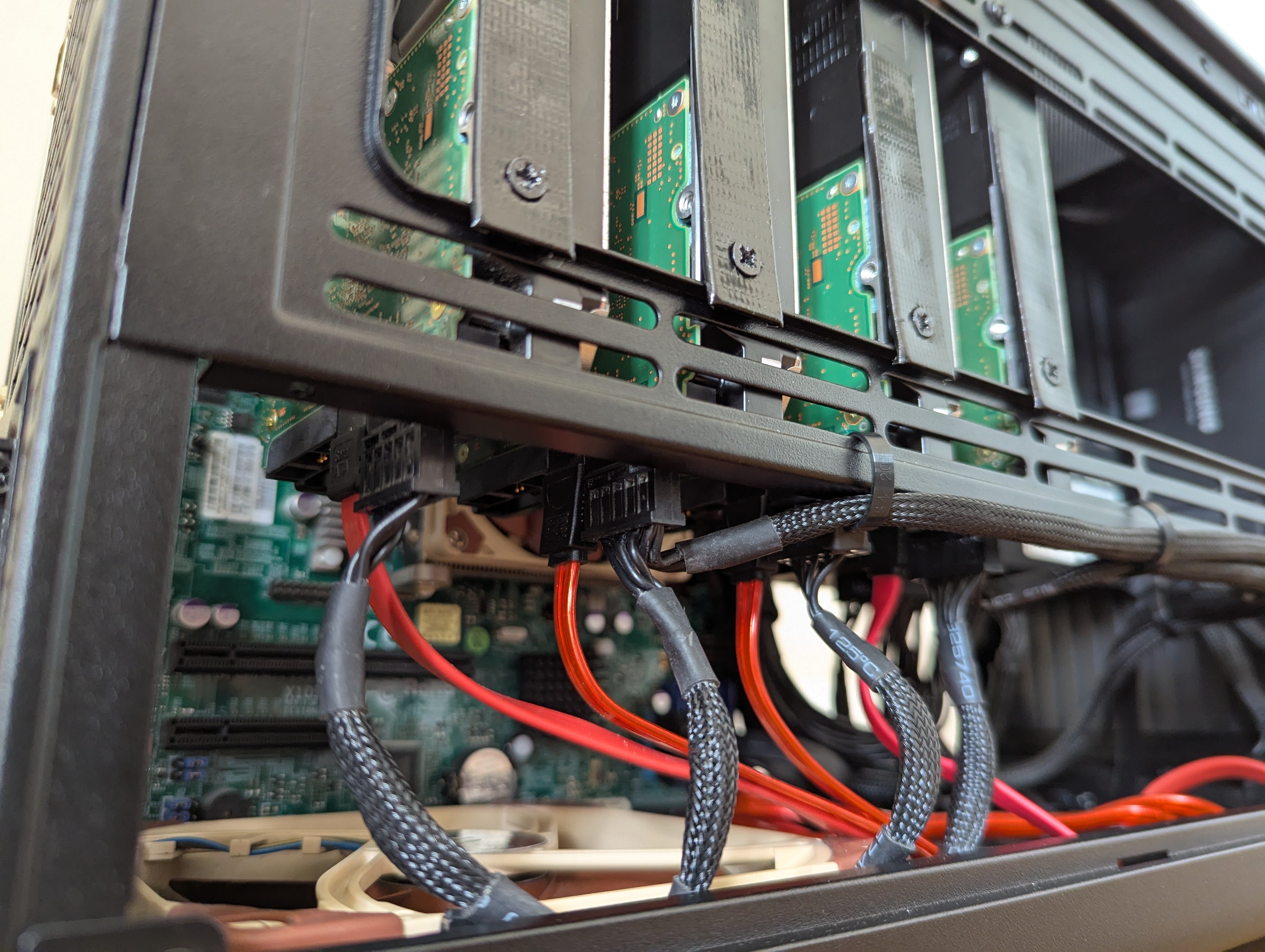

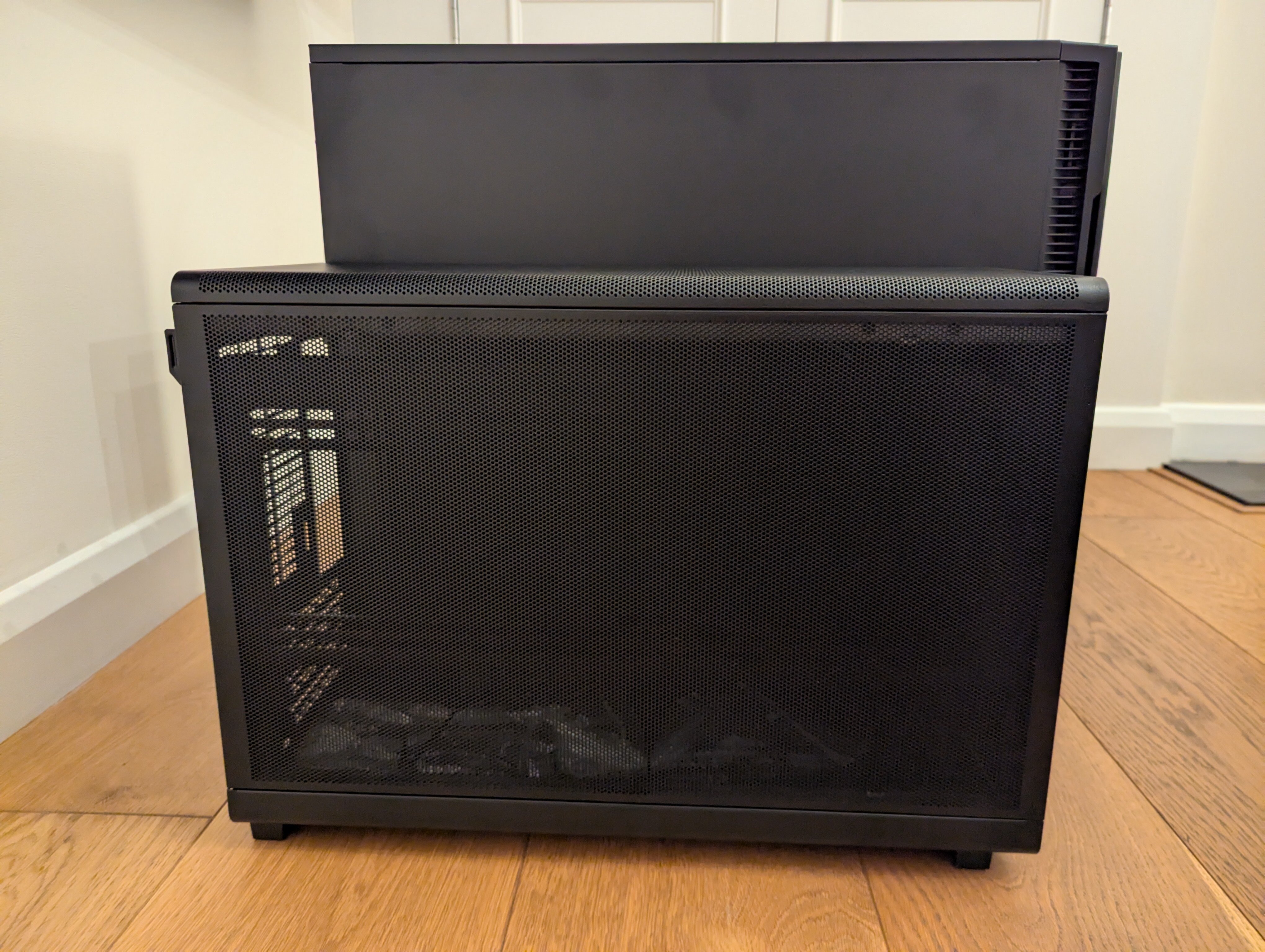

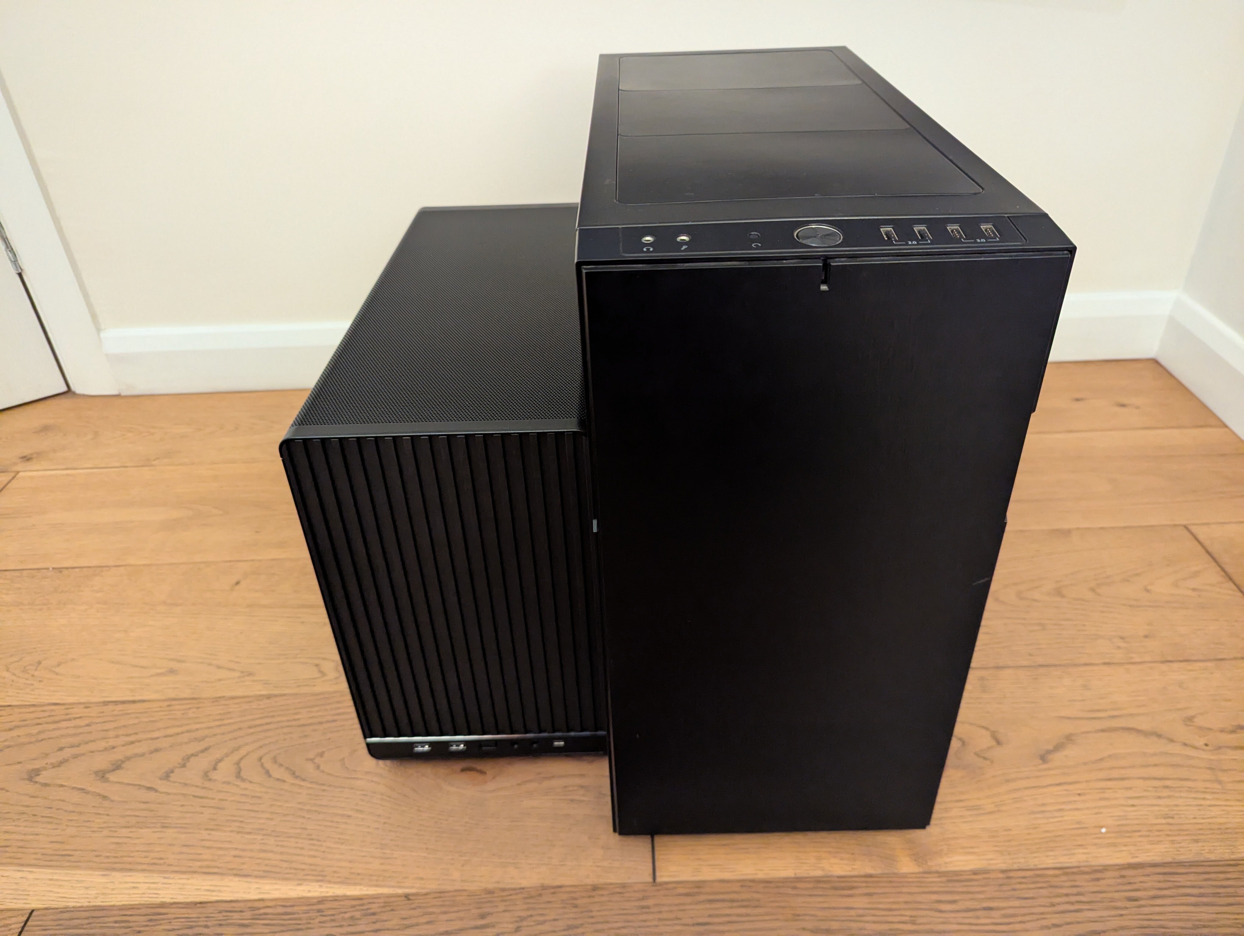

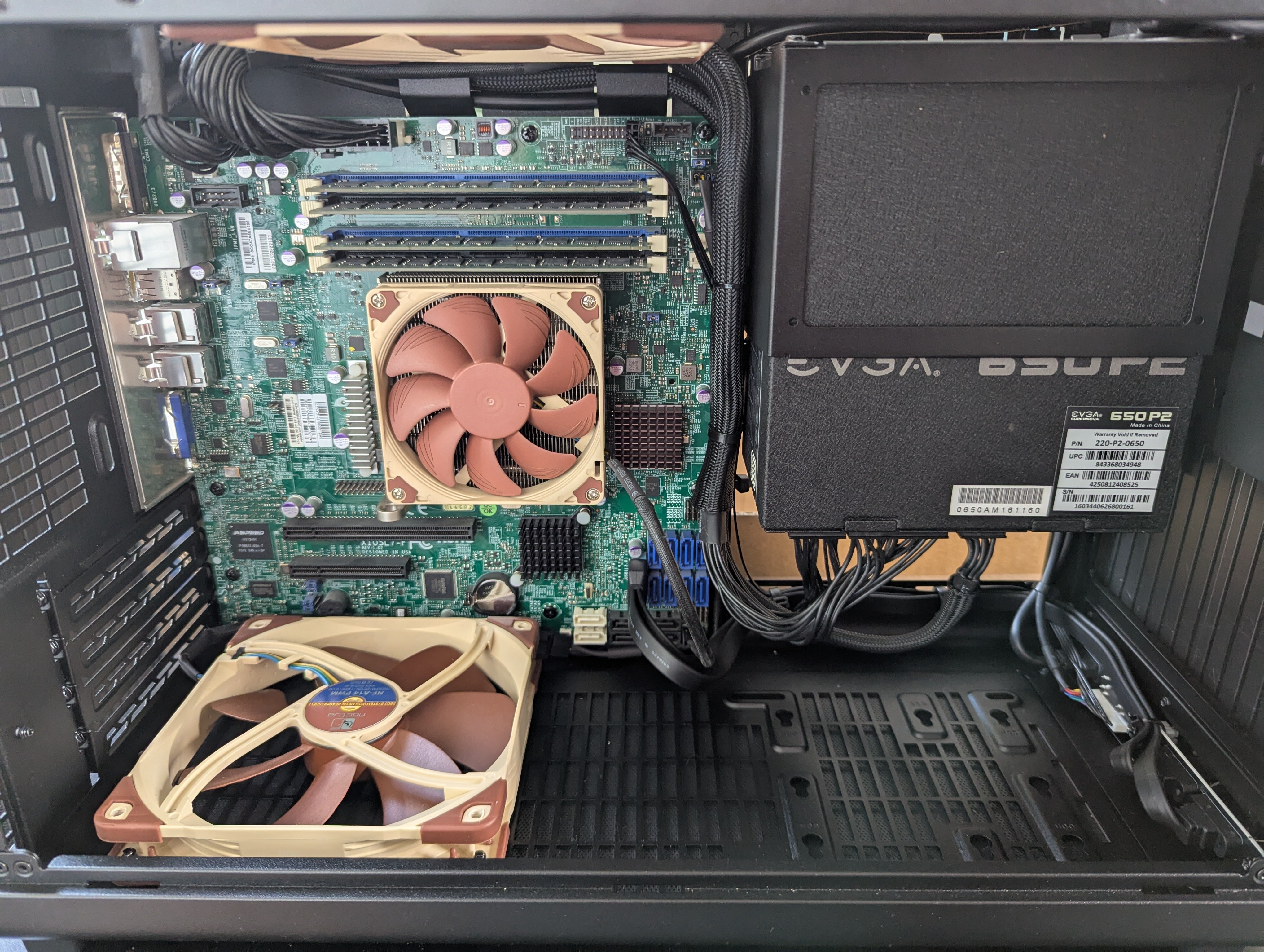

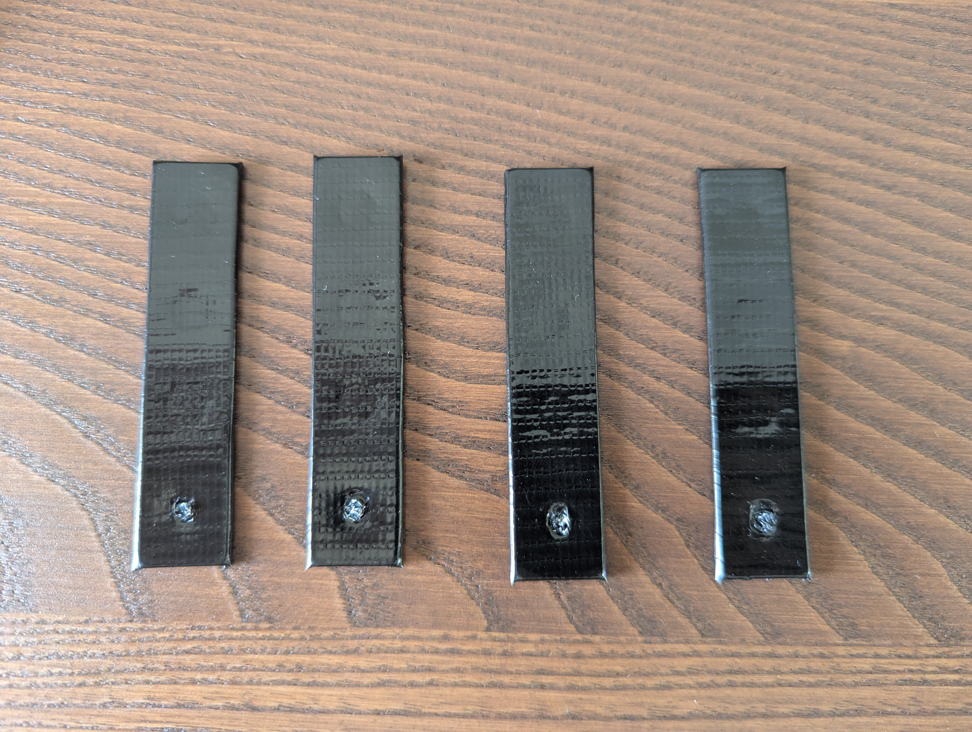

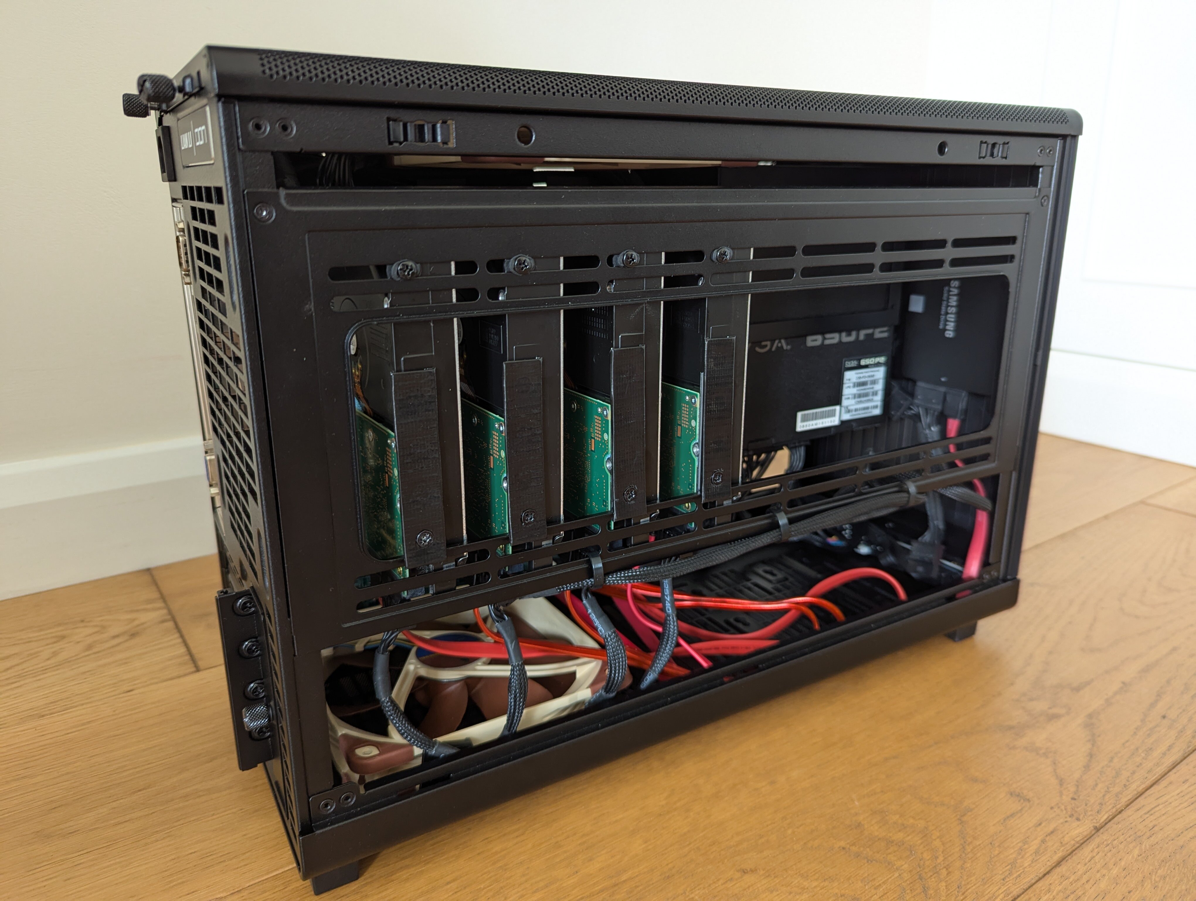

I wanted to downsize my build, the Fractal Define R5 and core system was purchased back in 2016 when I first got into Unraid, I wanted to find an mATX case that could fit a minimum of 6 drives without spending a fortune or having to change any hardware. Specs Supermicro X10SL7-F Xeon E3-1231 v3 32GB ECC DDR3 4 HDD - 1 SSD EVGA 650 P2 Platinum PSU The Lian Li A3 DAN case looked perfect, I figured I could use the GPU side bracket as a HDD bracket, I used off the shelf metal brackets wrapped in some black tape. Idle power draw is 20w. The case is very nice with great build quality and tons of air flow, and options to add more drives if needed at a later date. Size Comparison Without any drives Brackets Fully assembled (side panel off)
Reduce power consumption with powertop
Thank you @mgutt for your detailed instructions. I have a Supermicro x10sl7-f that was using 38watts of power with the drives spun down and over 60 when in use. [E3 1231 v3 Xeon] I enabled power top and learnt that the onboard SAS controller was preventing it from going past c3. Set the jumpers on the motherboard to disabled for the SAS, lan 2 and VGA output. Disabled PCIe in bios along with powertop - auto-tun My server now goes into c7 with a 20w idle. 5 x 3.5" and 1 ssd spun down. 4 WD 3.5"'s running draws around 35w in basic use. Has anyone else managed to get a below 20w idle on this board.
