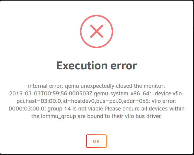

I appear to be having issues with the GPU pass through. It is an RXT2060

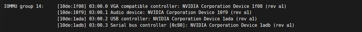

The error i get for Group 14 is the group the graphics card has.  Any ideas?

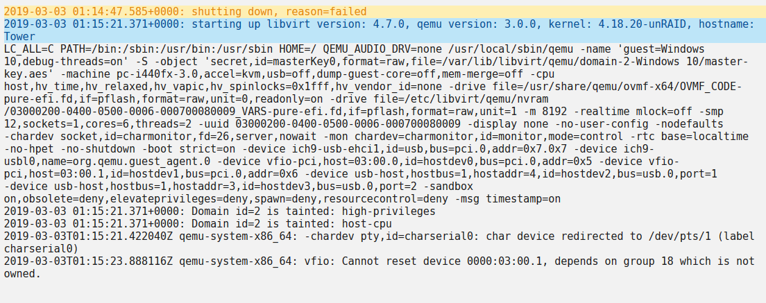

It appears a reboot corrected part of this.  The VM booted up.  I have no signal on the HDMI out of the graphics card, this was showing the console for unraid before the vm booted, and the following in the VM log.
Edited by InfInIty
Pass thru everything in group 14. You could manually edit the xml or stub all the things in the group.

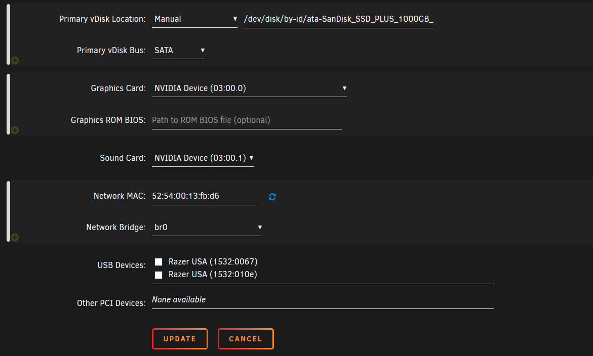

Not sure what else to try here.  The VM says it has started in the VM tab, but i get no output to the monitor, and the only way to shutdown the vm is to force it.
It looks like I may have gotten this to work.
I created a new VM passing the disk through with the by-id method and just using VNC
I did this just to test and make sure the disk pass through was working.  This worked
I then added the Nvidia card as a second GPU to the VM
This worked
I then removed the VNC graphics driver and booted it
It worked.
Honestly not sure how because i reverted back to not ungrouping IOMMU or passing the builtin USB and Serial controller from the RTX card
Currently downloading Heaven to it to see if it will run.

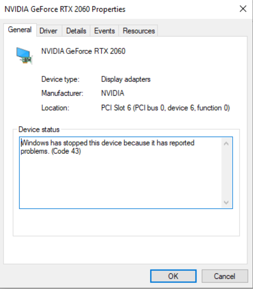

Well I got it working through SeaBios, but for some reason that way it would only see 3 cores and 6 threads, regardless of how many I assigned.
So i rebuilt some stuff making sure everything was built and setup for UEFI and i can get the VM working with VNC, but as soon as i passthrough the RTX2060 it does not show any video. I added it as a secondary card to VNC, and when i get into the system it says the RTX card has stopped because of errors code 43.
This did not happen on Seabios.   Any help would be greatly appreciated.
Post your xml and I will try to help you out
Here it is, and thank you.

First remove the vnc video then save the vm. Then go back and add this under the </video> section towards the end off the xml. This would add the other 2 devices of group 14. Also go back to OVMF...

Also change that ssd bus type to virtio
Sent from my SM-N960U using Tapatalk
Ok, but I am passing it through, dont I want it to be sata?

Here is the error i get
I've never code 43 errors myself do you have hyper-v=Yes when you created the VM?
No, it is set to disabled.
yea you need to turn that on. It on for all my windows VMs.
Several places I have seen it say explicitly to turn it off for Nvidia cards, because they dont work if they think they are in a virtual enviroment.
No turn it on or you will get the code 43. I game everyday using a 1070 with it on.
