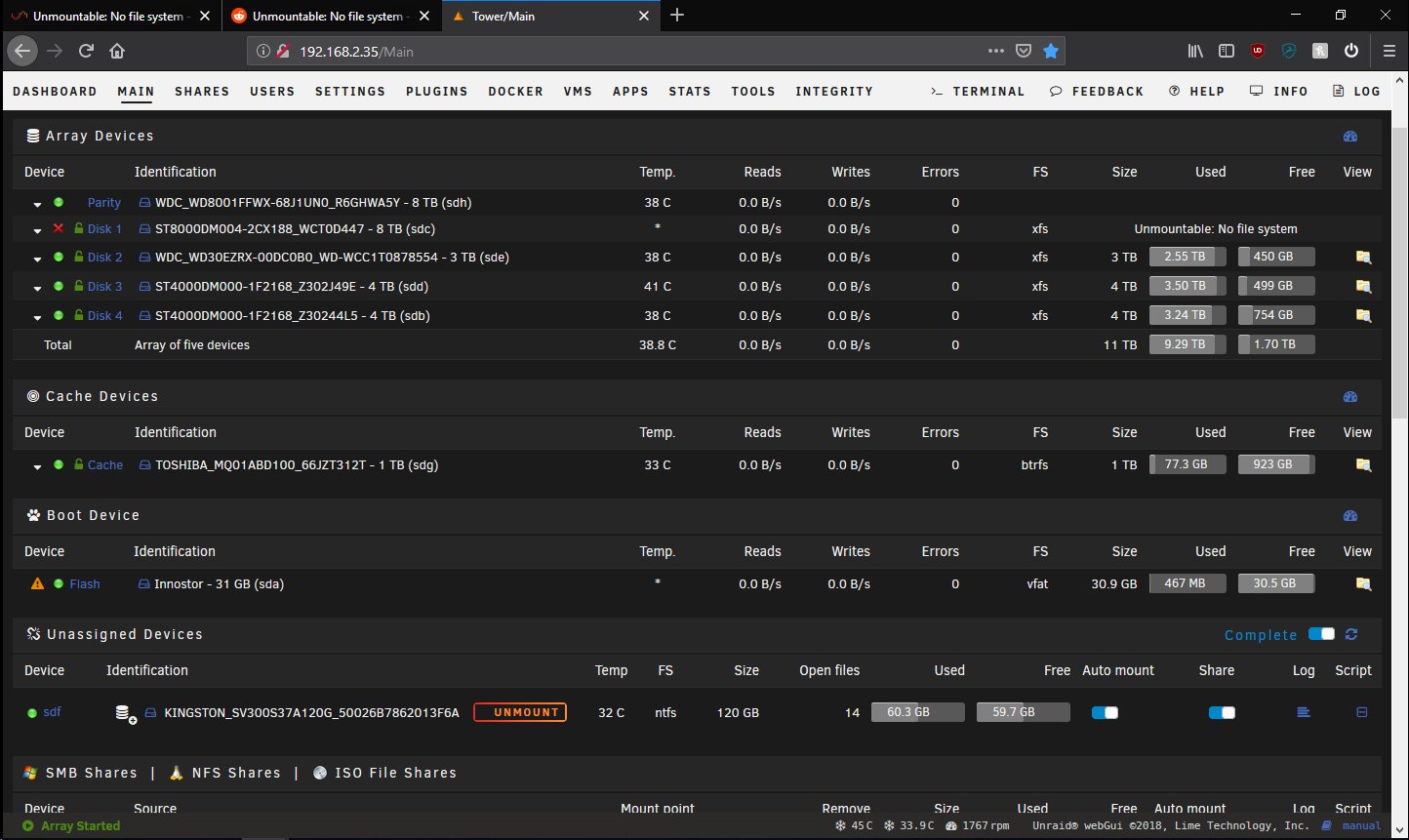

Hey guys!
On of my server's external HDD's has had a loss of power last night.
This morning, all HDDs are seen by Unraid, but my 8TB eHDD is showing as Unmountable: No File System. I've already searched the forum and tried the following command in maintenance mode:  "xfs_repair -v /dev/md1"
However, I get a "Cannot open /dev/md1: Device or ressource busy" error.
Oh, also, I have a Single Parity setup. Fairly noobish here so please go easy on me!
Any ideas? Thanks for any assistance guys. (Before saying it, I know I should have other backups. But Having a spare 19TB of storage is costly :(  )

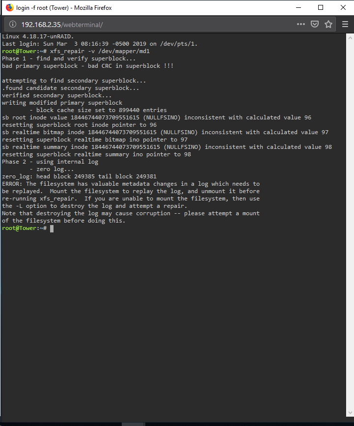

Don't copy past from the forum, sometimes extra characters are inserted, either that or you're using encryption and if so that's not the correct path.
Alternatively use the GUI.
I am indeed using encryption! And I haven't copied-paste from the forum. I typed it in manually.
Picture attached FYI
Then the correct command is:
xfs_repair -v /dev/mapper/md1
BTW, the disk is disabled, so you'll be running xfs_repair on the emulated disk, disk will need to be rebuilt.
And if you do it from the webUI then it would do it correctly for you and you wouldn't need to know the path. Just click on the disk and go to Check Filesystem Status

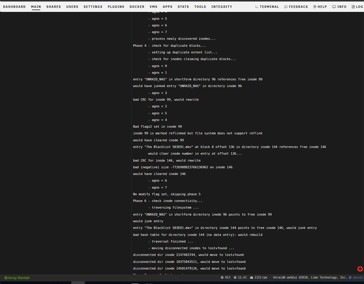

trurl - Currently at: "Phase 1 - find and verify superblock..." on GUI

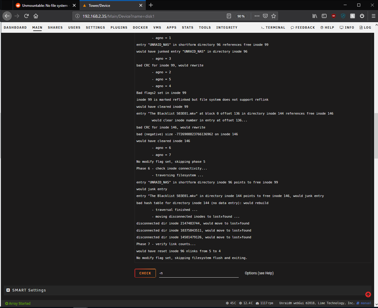

johnnie_black - See attached screenshot
trurl:
@plm42  Not quite sure from the screenshots what you have done so far?   You need to rerun the check using the -L option because of the metadata warning (it is virtually always safe to ignore that warning and without the -n option (or nothing gets repaired).
as was mentioned the disk is marked as disabled which means Unraid is only checking the emulated disk and is not writing to the physical disk.    This is useful as if anything goes wrong repairing the emulated disk you still have the physical disk as it was at the point it got disabled to use as an emergency fall-back.
Assuming the repair of the emulated disk goes well then you will have to do a’rebuild’ to get the physical disk back inline with the emulated one.

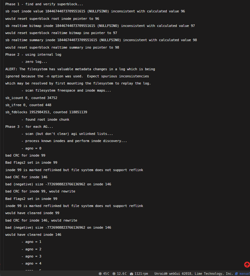

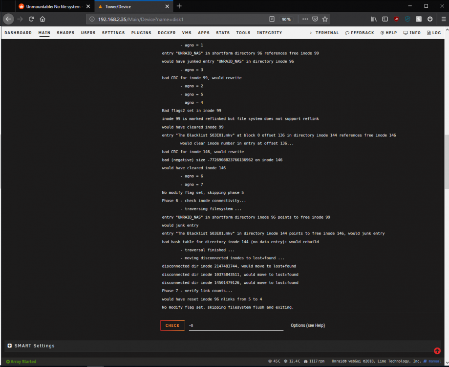

Only ran check with -n.
Will rerun with -L right away and post back.
