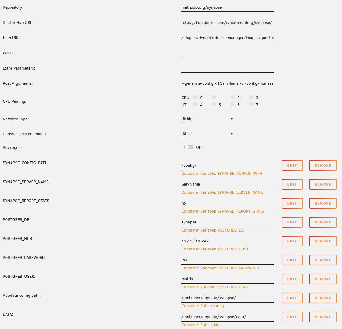

I have also been trying to get synpase to work on my unraid box (still running 6.6.7).
I installed Postres without a problem.
I'm having a similar issues as you relink with the synpase docker.
I downloaded a clean homeserver.yaml from https://raw.githubusercontent.com/matrix-org/synapse/master/docker/conf/homeserver.yaml
When i start Synpase, it immediately crashes. I joined a screenshot of my container template and here is the console log for the synapse container:

Would really appreciate any tip as to how to setup synapse.
One part of it is setting up my let's encrypt reverse proxy to work with it.
