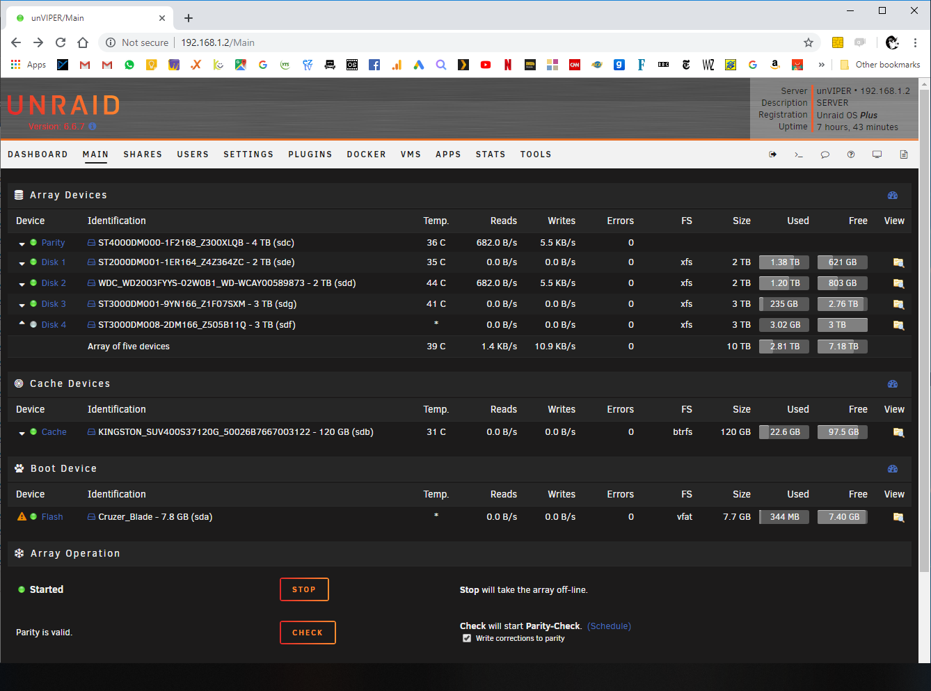

Hi Everyone,
Thanks for all replies. Maybe I cant express my self well enough, sorry.
I understand how everything works! :D
I know data is written to the cache (witch in m case is an 120gb ssd) and then moved to disks with parity - (these are 5 mechanical drives). Not all shares are using cache due to its low capacity.
I only work on the files from the shares..

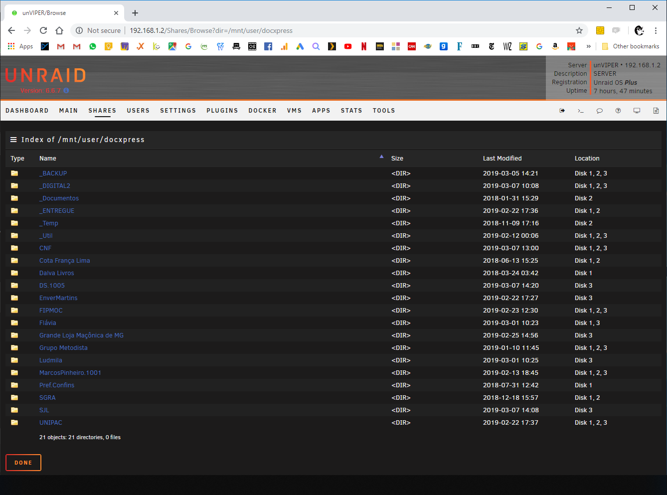

image.thumb.png.19a6f4d3f777239b3c53e99c00fd3aad.pngThe folder I have to delete is the one called "_digital2". Data is located on disks 1, 2 and 3 like I said.
That last screenshot indicates the folder named "_DIGITAL2" is in the User Share named docxpress. And just in case you aren't aware, it is not called "_digital2" because linux is case-sensitive.
With so little cache, I would reserve it for use only by your dockers and VMs; i.e., the appdata, system, and domain shares that are cache-prefer. All other shares set to cache-no. No wonder you were filling it up.
It has enough capacity for some other things as well if you want fast storage for a little bit of stuff, but it isn't big enough to cache writes to the array in my opinion.
