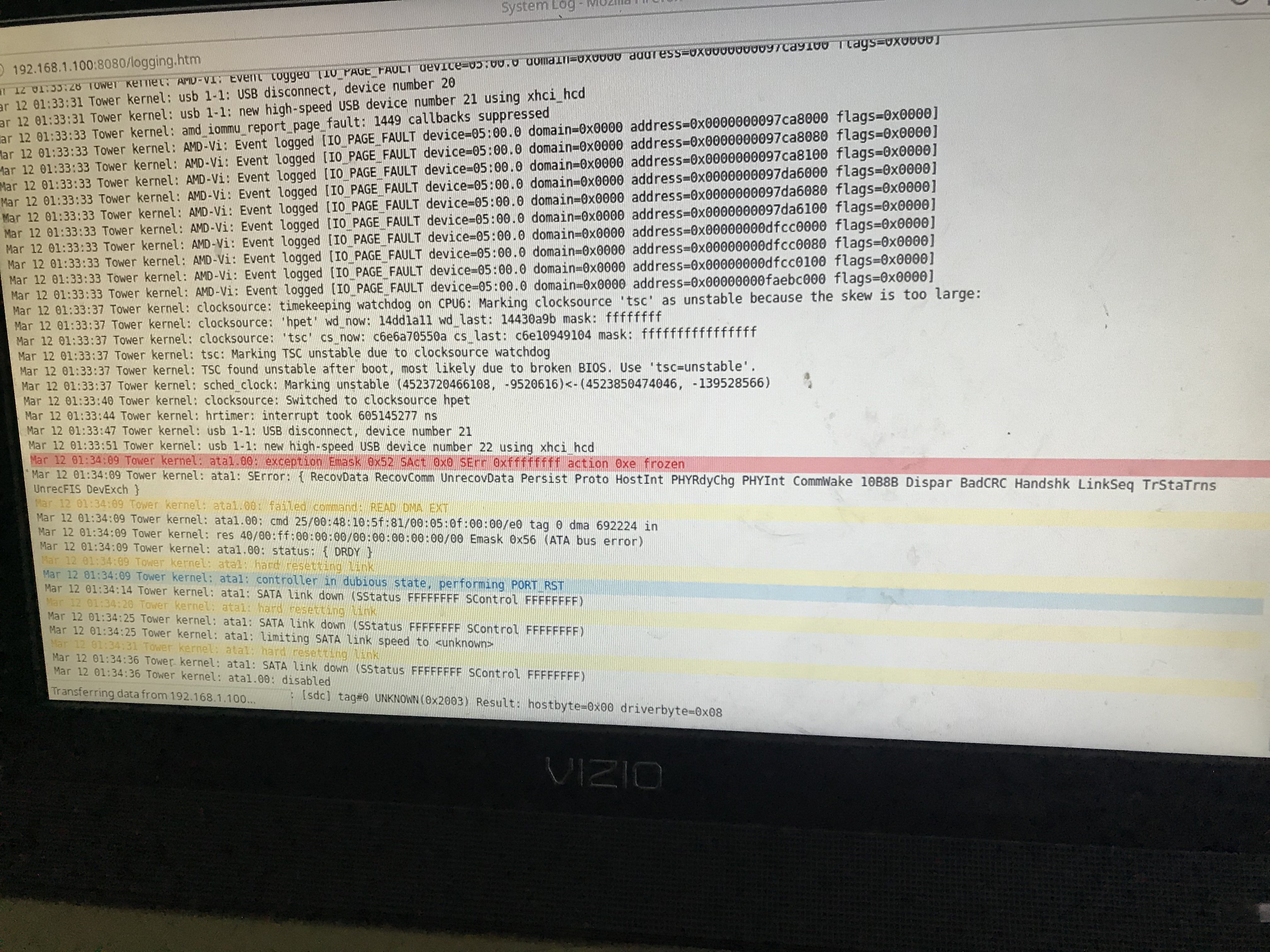

Hey guys just remembered. I grabbed this screen shot earlier today before the last crash.
AMD-Vi and IOMMU are to do with hardware passthrough to a VM. The ATA error messages are about a SATA link failing and the disk dropping offline. The controller repeatedly tried to re-establish the link but doesn't get a response. Grab diagnostics before you shut down to check both power and data cables.

Hey guys. So apparently, troubleshoot mode doesn't exist as I am on 6.7.0.
I have attached an image of my monitor when the server crashed as well as the system log from logging.html.
It seems when I start the array and the rebuild takes place. There is a huge amount of errors to disk1 and then the server crashes. This could be inline with whenever I am trying to build out a VM and I browse for the ISO file it will crash the unraid server since it starts to read from disk 1. I don't know exactly which disk is disk1 but I am going to reboot and see if I can find that out. I really am starting to think it's a bad sata controller. Let me know what you think.

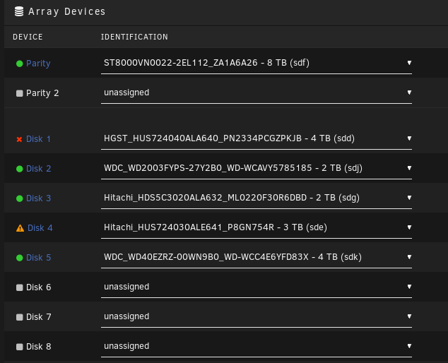

I went to do that. Powered unraid on, but now looks like I lost another drive, this time it's disabled entirely. I'm afraid that if I start the array I am going to have two emulated disks and I won't have my data in parity. Wondering now what the best option is. I don't know if the constant resets got to this or if the sata controller really is messed up and has been causing issues all along. Sorry guys, really trying to get you the logs, how should I precede?
Unraid can't emulate two disks with single parity, a new config should recover disk1, but disk4's data might be damaged, since it looks like it was in the middle of a rebuild.
So if I use the new configuration option I can probably get the array back online but disk 4 will need to be rebuilt from the parity?
You can force a rebuild but success depends mostly on if there were any array data changes since it got disable, if you want to do it I highly recommended using a new disk, so you can keep the old one intact.

Please post the diagnostics instead: Tools -> Diagnostics, also what you want to do, rebuild disk4?
