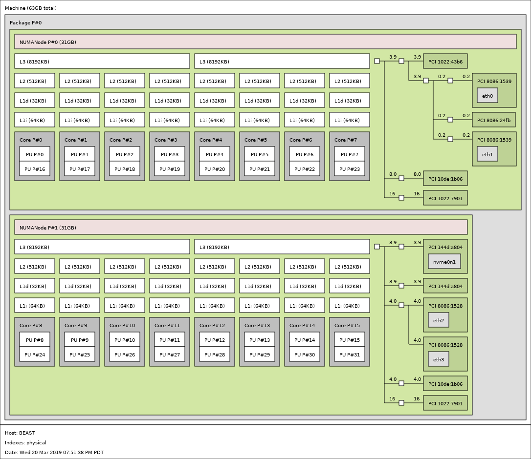

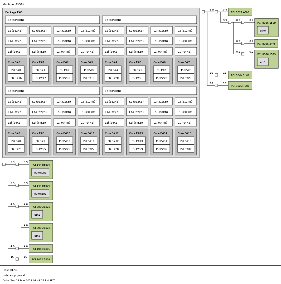

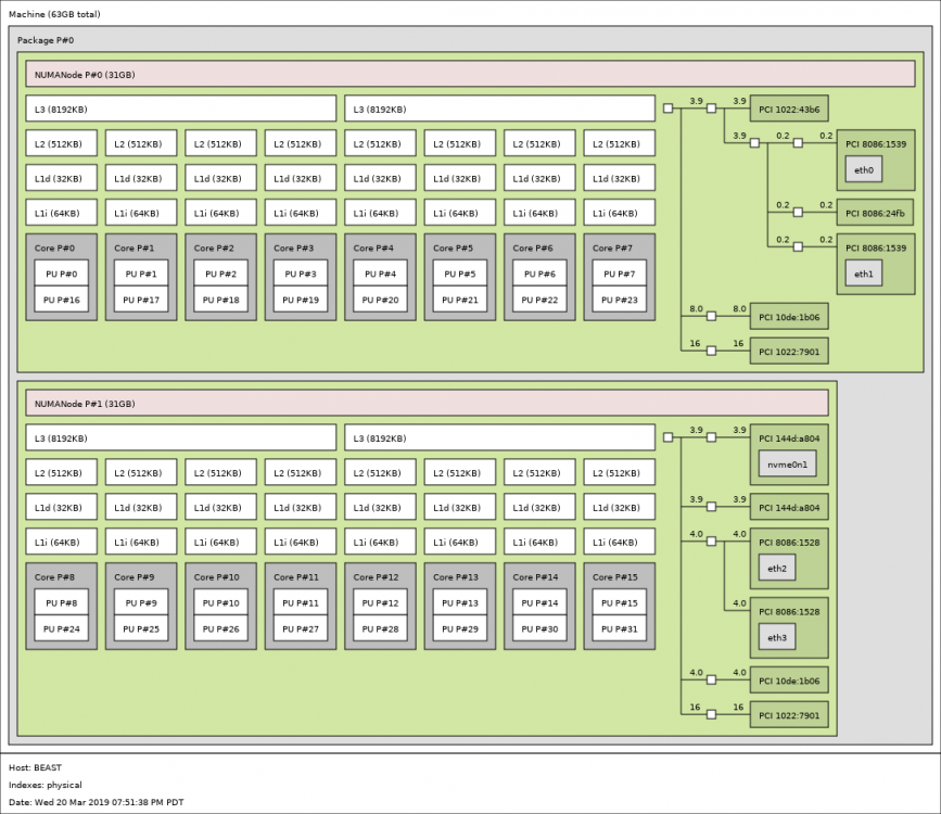

@bastl How does one determine which device is in witch PCIe port?  I have two identical 1080Ti's.
Also, how did you determine which NVMe controller to pass through?  I like you show 2 NVMe controllers.
Attached is the output I got from lstopo,
Edited by IamSpartacus

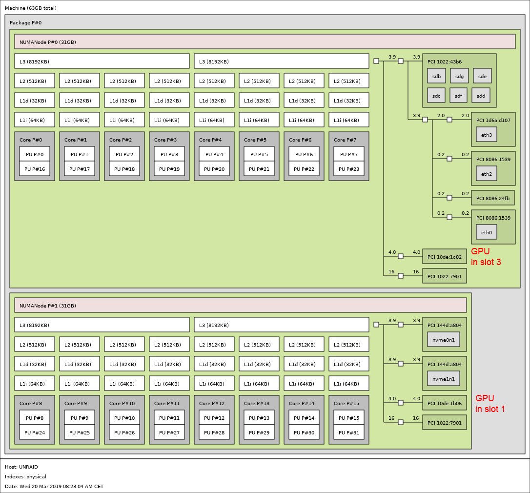

@IamSpartacus I'am not exactly sure how you better can check which card is connected in which PCIe port in your case. Unplug one card and check LSTOPO again and you will see which port the one card is connected to. I have 2 different cards. "10de:1b06" should be a 1080ti.
The controllers of my 2 NVMEs are the same, right. One is a 960 EVO (cache nvme1n1) and the other is a 960 PRO (passthrough nvme0n1). The main tab on the dashboard shows me the cache device as nvme1n1. That's how i figured it out
Also mentioned you're running in UMA mode. You should find an option to change the memory interleaving config from "auto" to "channel" somewhere under "Advanced/CBS/DF something" in your BIOS.
Edited by bastl
The NVMe's I got figured out just like you said, based on the UD plugin.  As for the GPU's I can't take them out of their slots because it's all together in a loop so I'd have to pull my loop apart.  I guess I'll have to do trial and error with those.
Thanks for the time on the UMA mode.  For this project I set my BIOS settings back to default to upgrade the BIOS to 2.30 and then the latest (I was on 2.00).  Once I get all my VM pass through config worked out I'll start testing OC's again.  Previously I was at 3.8Ghz with 1.24vcore which I'm fine with if that's the best my chip can do.

@bastl Here's my new lstopo output (you'll notice one NVMe gone as it's passed through) to the VM.
I'm not having great luck with passing through my 1080Ti's though.  When I try to pass through the GPU in slot 1 I get Error Code 43.  When I try to passthrough the GPU in slot 3, it works but the screen goes black a lot.  Sometimes every few minutes, sometimes every few seconds.  I'm using the latest Nvidia drivers.

@IamSpartacus To passthrough a card in slot 1 I have to specify the VBIOS for this card in the XML otherwise I have the same issue.

Did you assigned cores from the node the card is attached to? Does it only flicker in games or also on desktop? Here as a example my main VM xml if you wanna play around a bit.
notes:
  • Unraid version 6.7.0_RC5
  • all cores on the second die are isolated
  • emulatorpin and iothreadpin limited to the second die
  • Q35 because of newly introduced PCIE-root-port-patch in RC5 (qemu part at the end needed) to have the OS and applications correctly notice the link speed of the slot the card is plugged in, otherwise Nvidia driver reports it as 1x speed only. For me feels smoother this way. not working for i440fx or on older Unraid versions
  • numatune set to use only memory directly connected to the second node
  • CPU model tweaks to get the right CPU cache reported to the VM
  • except of the qemu part everything also works on i440fx type VMs for me
  • VBIOS of the card dumped and modified, removed some Nvidia header (SpaceInvaderVideo)
  • MSI_fix applied for GPU and audio devices
  • CPU Scaling Governor set to "On Demand" (Tipps and Tweaks Plugin)
  • some Windows settings tweaked, the usual stuff, power plan to high performance, a couple services disabled etc.

I bet the layout will be the same as for me. Slot1 is connected to node1 and slot3 to node0.
