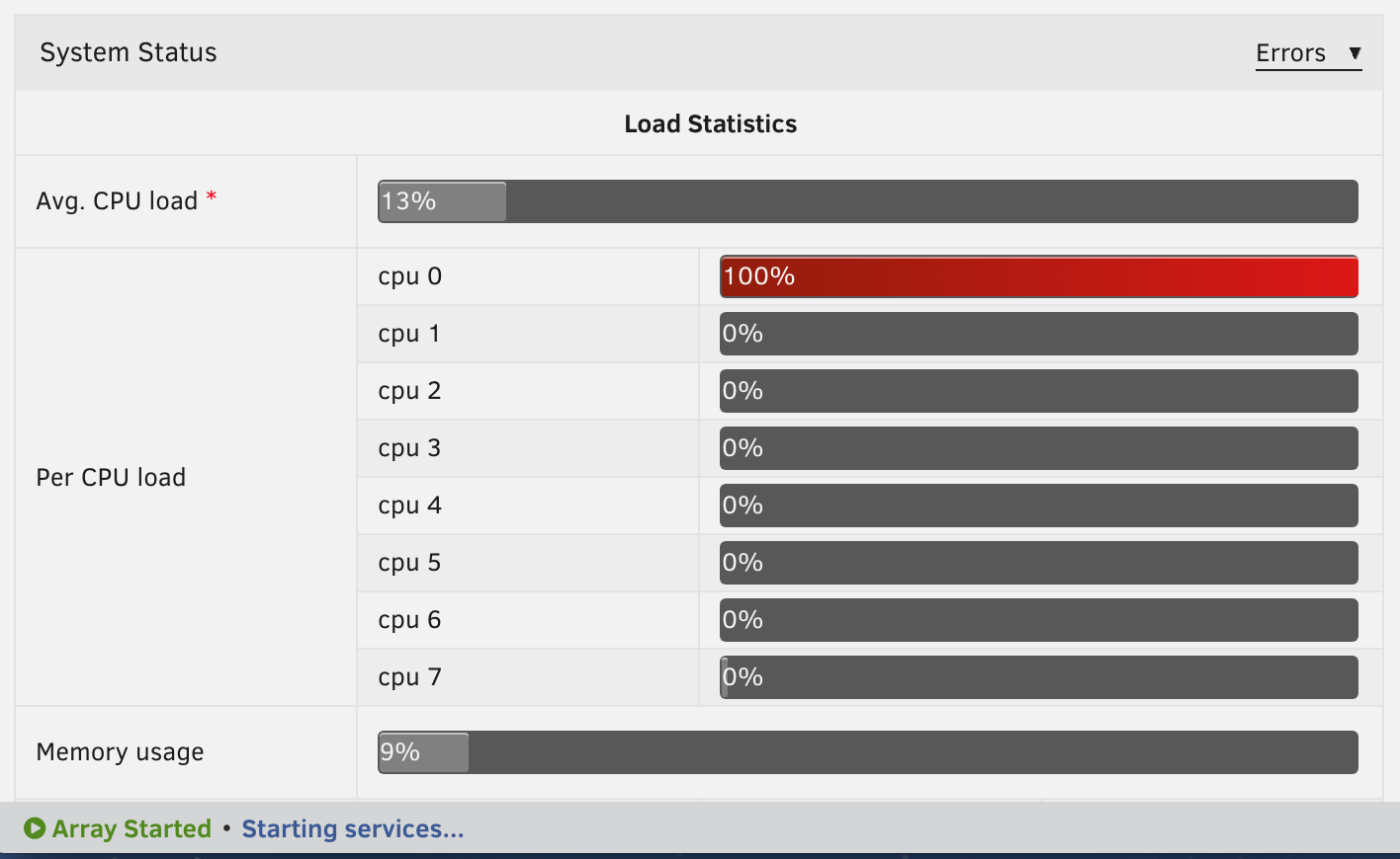

I attached the new diag. I just upgraded to 6.6.7 and enabled docker. One of the CPU cores shoots up at 100% and it seems like it is stuck in "Starting services". If I let this go on, eventually all the cores will be at 100%.
I tried to pull the diag again, but this time I could not do it. I tried the GUI and CLI per your instruction, but it seems like the system could not get the information. I waited 15 minutes, but no diag output from both GUI and CLI.
