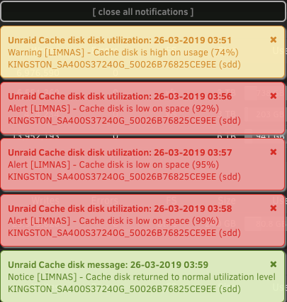

I've got a weird that happens every night. Cache seems to get close to the edge and then back to normal in a matter of a few mins.
Normally she looks like this:
To what stupidity am I subjecting myself?

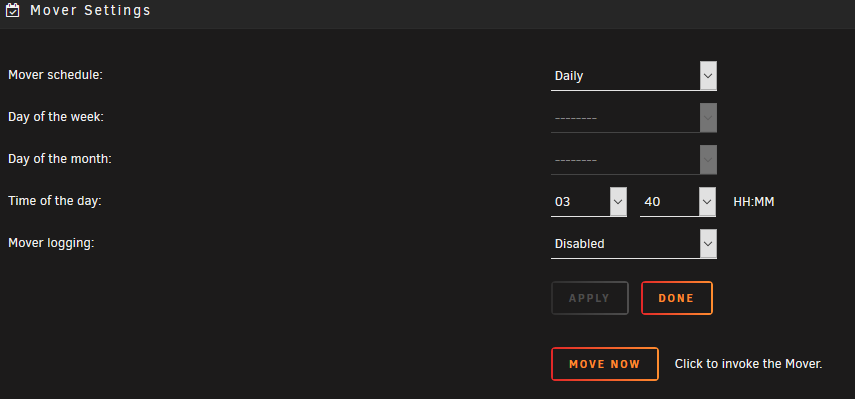

So it looks like it's the Mover as it's shceduled for that time:
But why is it filling up the drive ?
Enable mover logging in settings schedule and itll log what its logging and you'll see in the syslog
