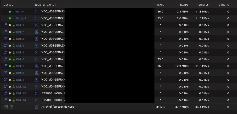

I tried limiting write speed to disk7 by adding the following extra parameter to the Krusader docker container:
--device-write-bps=/dev/mapper/md7p1:10mb
Seems to work as intended (see capture attached).
