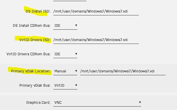

It is possible to use these .vdi files on Unraid without any conversion.    To do so you need to enter the full path to the .vdi when specifying the vdisk entry while setting up the VM as the GUI does not provide support for selecting it via a drop down.
From what I've seen from the Qemu Wiki page, VDI should be supported as long as it has no snapshots an consists as a single file.

what is the exact location I need to specify the .vdi full path ?

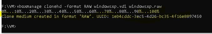

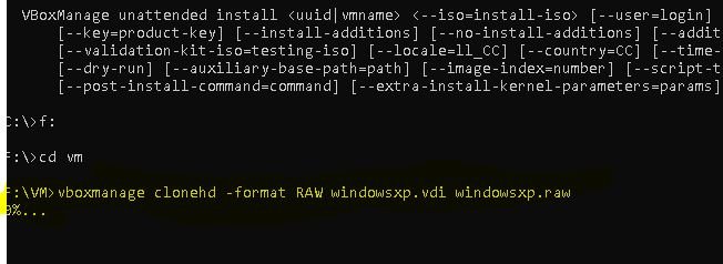

With the following command with Virtualbox you should be able to convert a VDI file into a RAW file that is supported by Unraid
ok, seems like the vboxmanage command is doing something..
I will update once the file gets created
Thanks

I would expect it to be the Primary vDisk location as the others are normally files contains iso images of CD-ROM or DVDS.  The .vdi file represents an emulated hard disk.   If the VM is to have multiple emulated hard disks it can end up with multiple .vdi files, one per emulated hard disk.

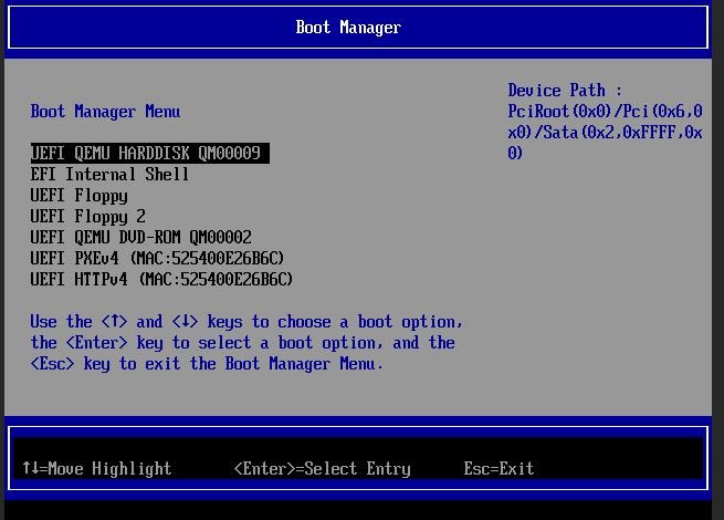

I tried with multiple settings  seabios, ovmf, ide,sata etc but was unable to make it boot from the .vdi files
I'm dropping out the idea of mounting .vdi directly as I don't know how to deal with the settings

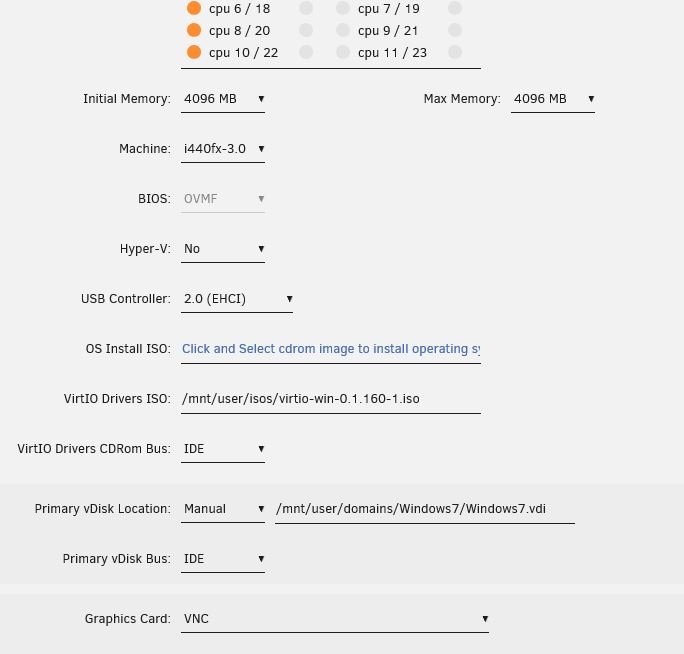

I regularly swap .vdi files between KVM on Unraid and Virtualbox running on a Windows system so it definitely works.    One thing you have to make sure of is that the OS inside the .vdi has appropriate drivers installed for the type of disk adapter chosen.   Typically a .vdi created on Virtualbox will have either SATA or IDE specified as the disk adapter type so the default of virtio set on a new VM on Unraid is not suitable.  You need to change it to match what VirtualBox was set up to use.   You can explicitly load virtio drivers into the OS while running under VirtualBox before trying to move the .vdi file to Unraid but that would not be done by default.
Thankyou itimpi
yes, selectied SATA had BSOD
again selected IDE, It's working great.
