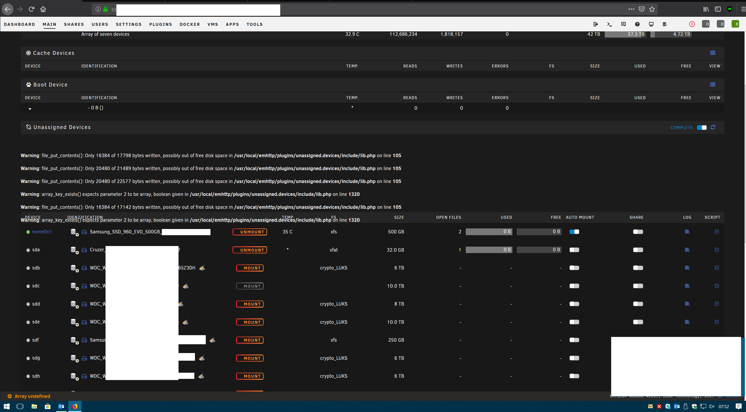

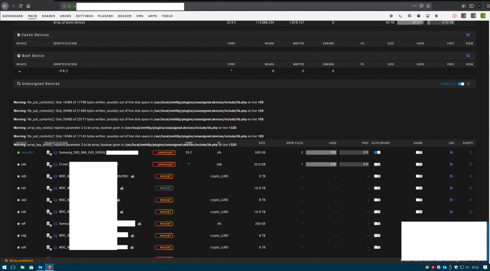

When i try to run diagnostics from GUI it doesn't allow, it says array unidentified.
I run the diagnostics command from terminal and i get this...
Warning: file_put_contents(): Only 0 of 838 bytes written, possibly out of free disk space in /usr/local/emhttp/plugins/dynamix/scripts/diagnostics on line 208
done.

its doing it again guys,
id really appreciate help

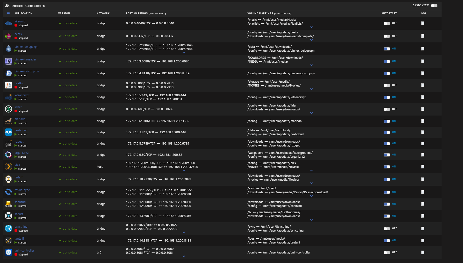

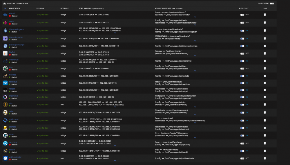

This is the docker list on the system, in case you can see any errors

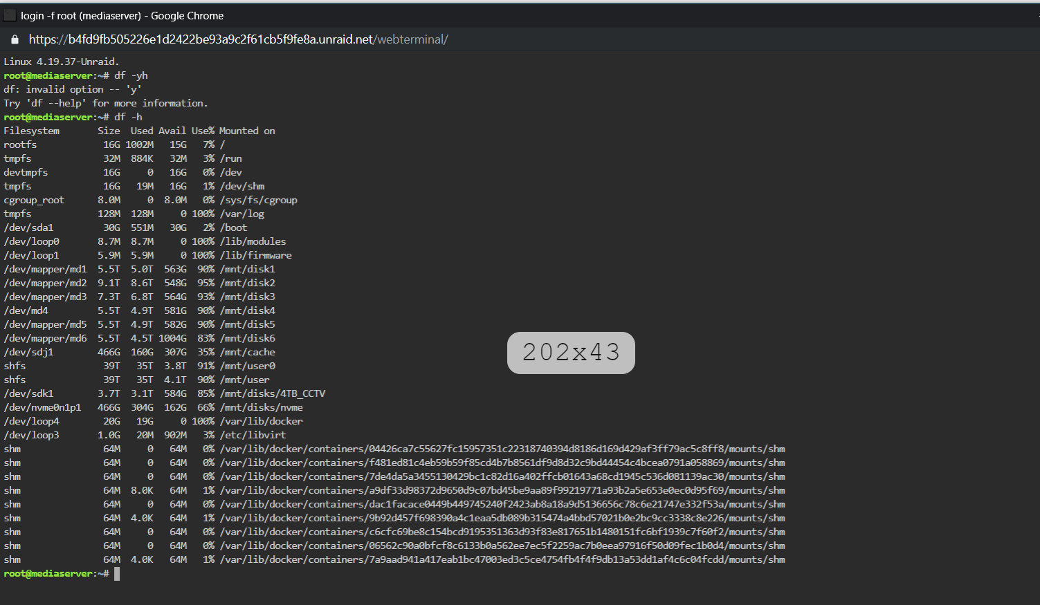

The error you get implies you run out of capacity in rootfs. Usually happens when something is written to a non-existing folder or a non-existing disk reference
Your current rootfs utilization is low, and you can monitor this by the "df -h" command
# df -h
Filesystem       Size  Used Avail Use% Mounted on
rootfs            16G  996M   15G   7% /
The mapping of resilio-sync seems a bit strange. I would expect a folder under /mnt/user
/sync --> /mnt/user
Your /var/log location is full which is abnormal.  You might want to try running
   df -h /var/log/*
to see what is filling it up.

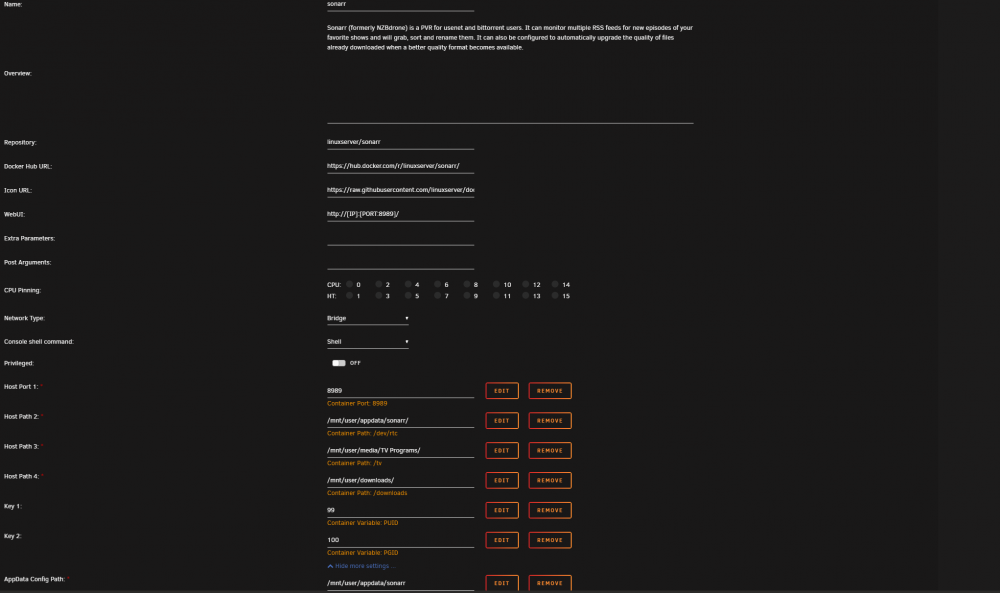

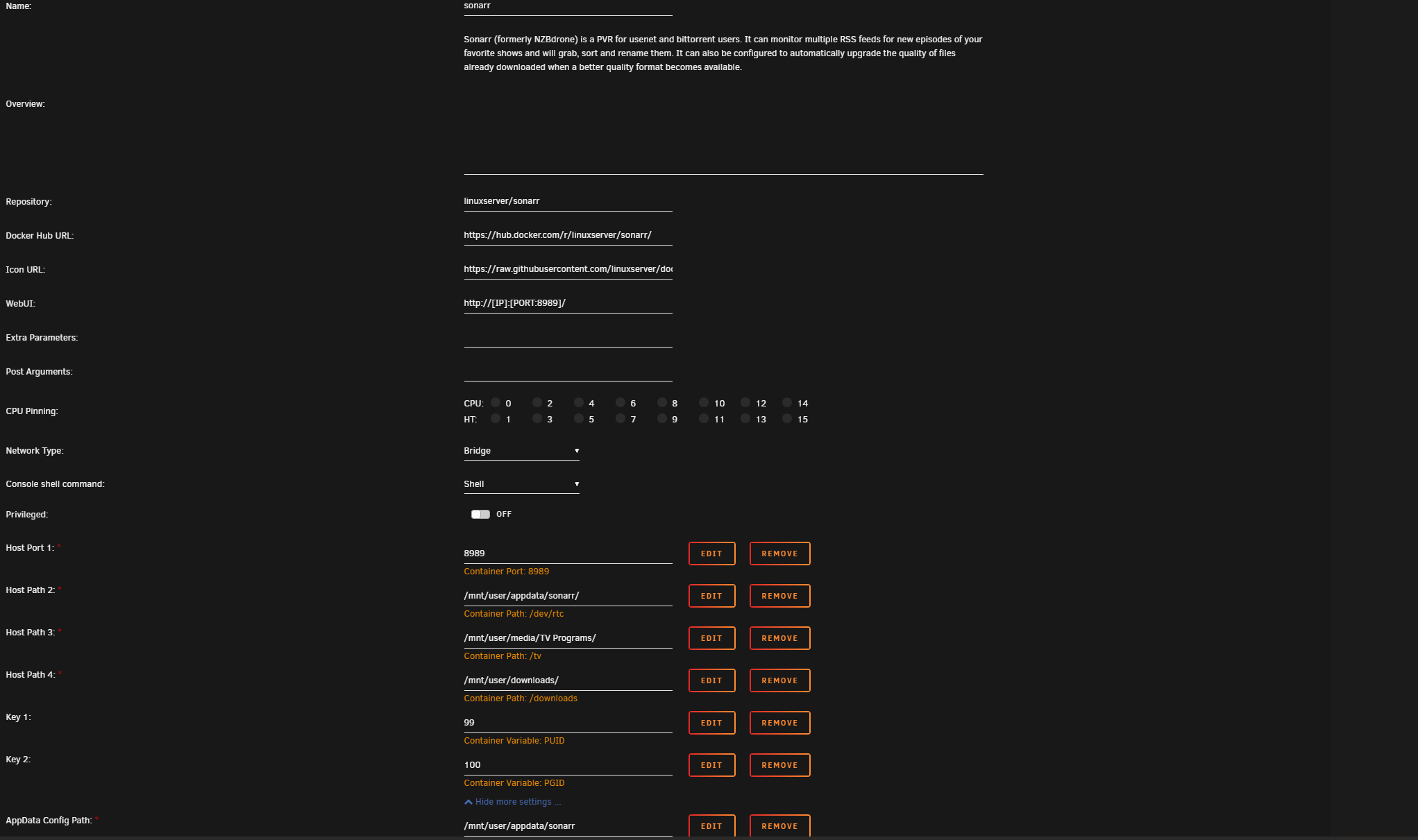

I think i have narrowed down the issue.  I stopped all dockers, then added back only the mainly used ones, then i went back to using only a couple and out of them i THINK it is to do with sonar and sabnzb :/
I have added some pics of the setup of sonar
