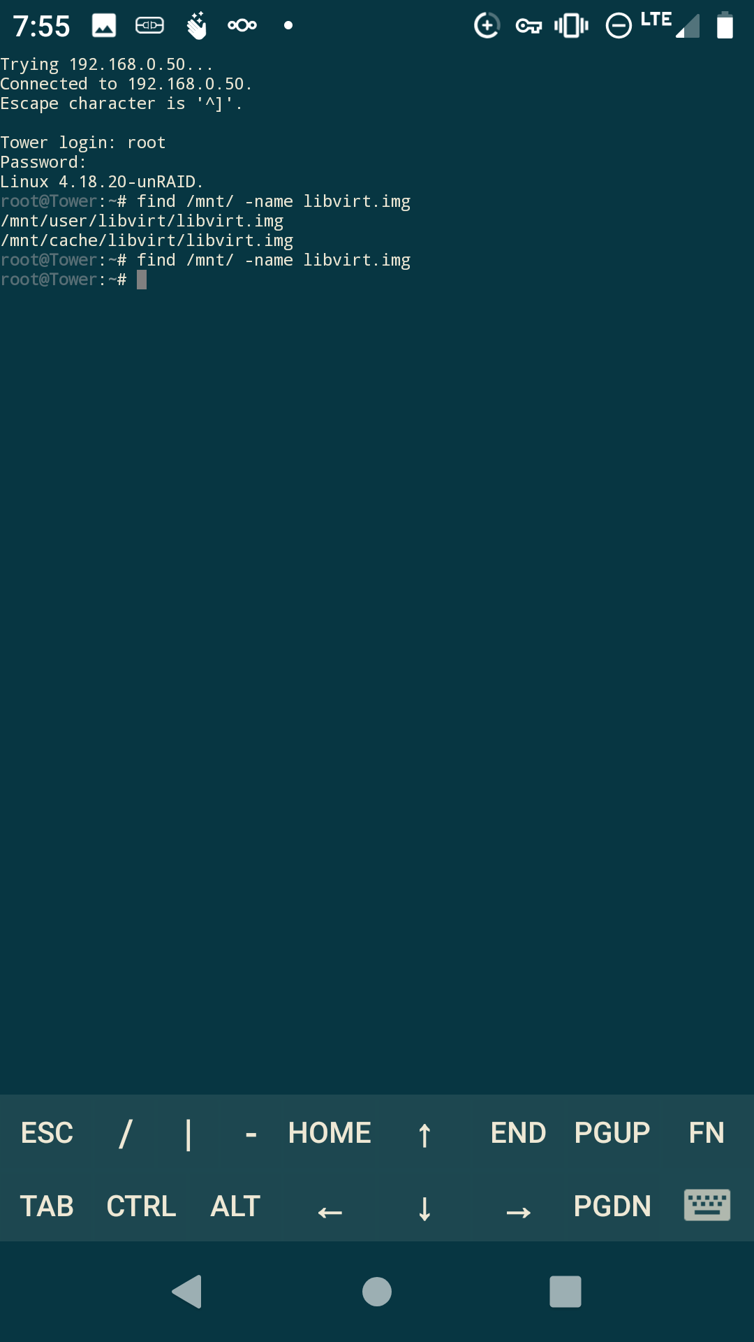

If you find all the libvirt.img files on your system then the VMs will not come back!    It sounds as if you have multiple instances of the file around.
Somehow the offending VM is coming back.   See attached screenshots.  I did find /mnt/ -name libvirt.img and it returns what I expected the one libvirt.img file.  I then went to settings VM manager and disabled VMs then deleted the libvirt.img.  I then went back to ssh and did the find again and as you can see the file is no longer found anywhere in /mnt.  So the existing libvirt.img was successfully removed.
I then rebooted Unraid went to settings then VM manager and enabled VMs and it immediately dropped disk3 and the other unassigned disk (understand why from previous messages offending VM has wrong pci passed through and is autostarting).  Then went to the VM tab and all those old VMs show up???
  How can this be created if there is no libvirt.img???
Hope attached shows that I have eliminated the multiple libvirt.img issue.
