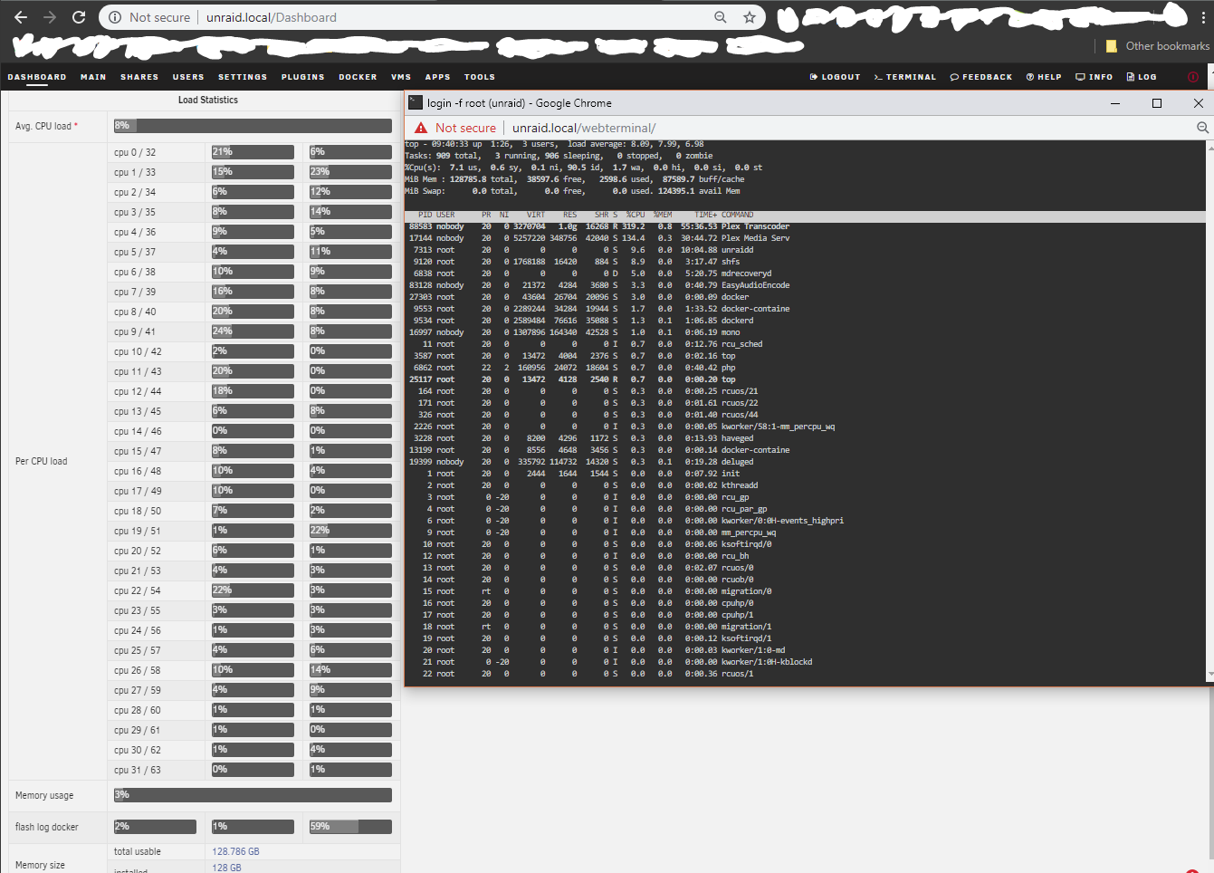

Other wierd behavior:  Ive noticed that there are discrepancies between the 'top' output vs the dashboard on utilization. Sometimes, minutes before a lock up described above, when I notice things arent behaving, the Dashboard will show one cpu pegged at 100%, then another, then 4, 6, then more till lockup, however during this time, 'top' shows basically idle.
Other times, when things are working properly, (in the screen shot attached, plex is working fine doing a transcode ) , 'top' will show way over 100% cpu usage, but the Dashboard will show less than 10% usage.

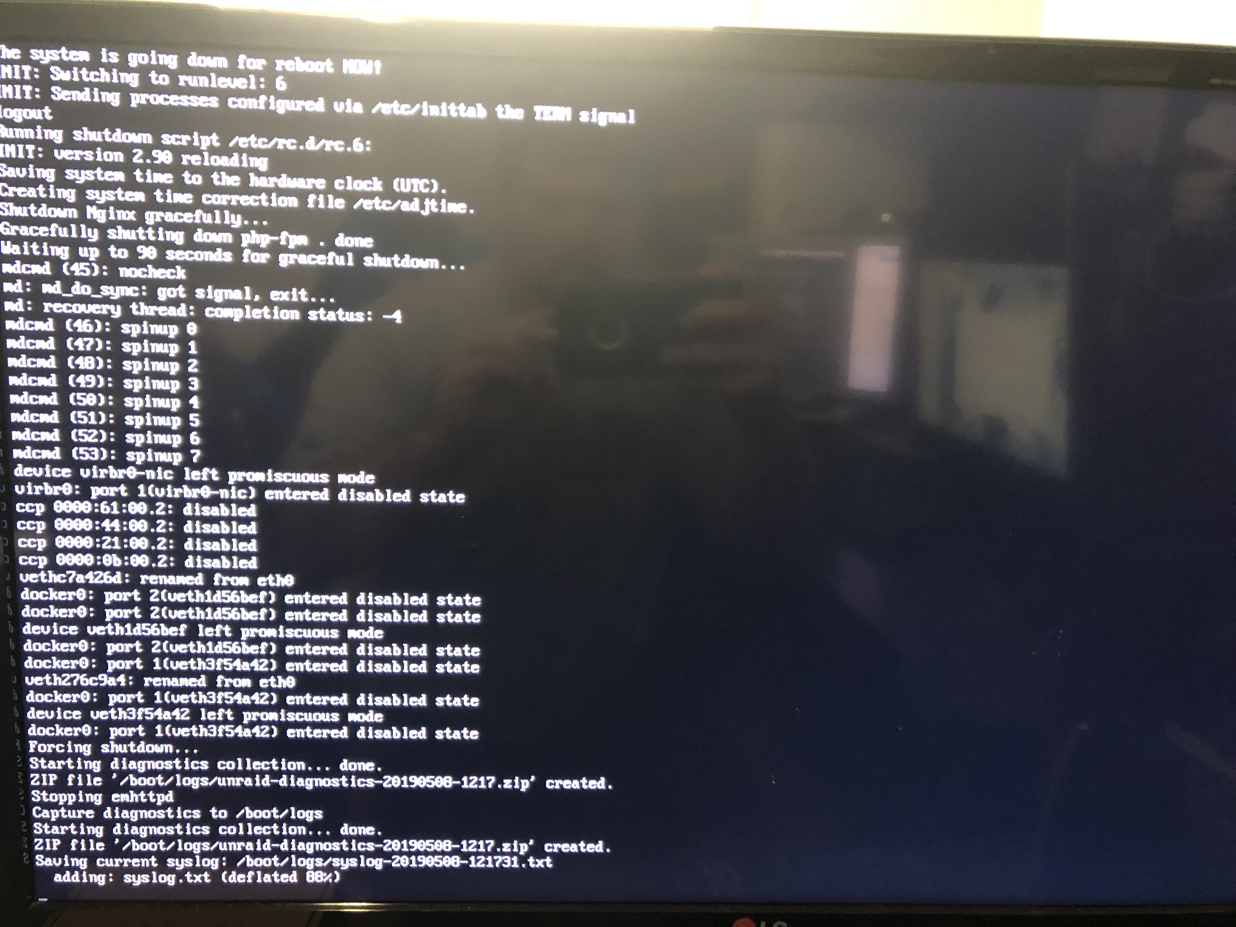

Example of how when it locks up I can still login via the console and issue commands like ‘reboot’ but they don’t actually work completely. The attached picture shows the output of my reboot command where it says “going down for reboot now” and all it’s subsequent output, however it’s been sitting like this for 10+ minutes now.
Time unfortunately for another reset.
