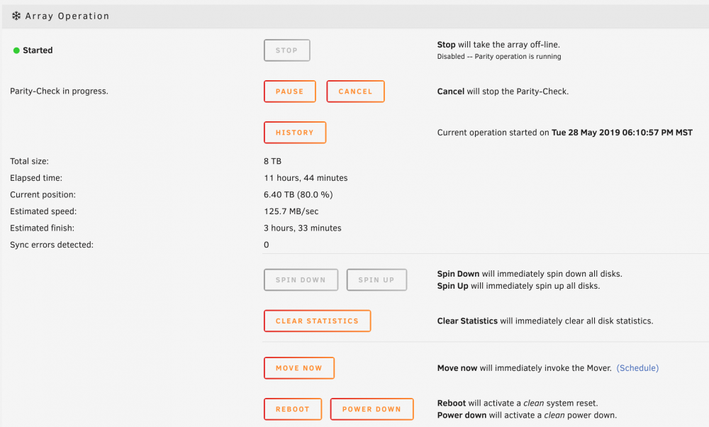

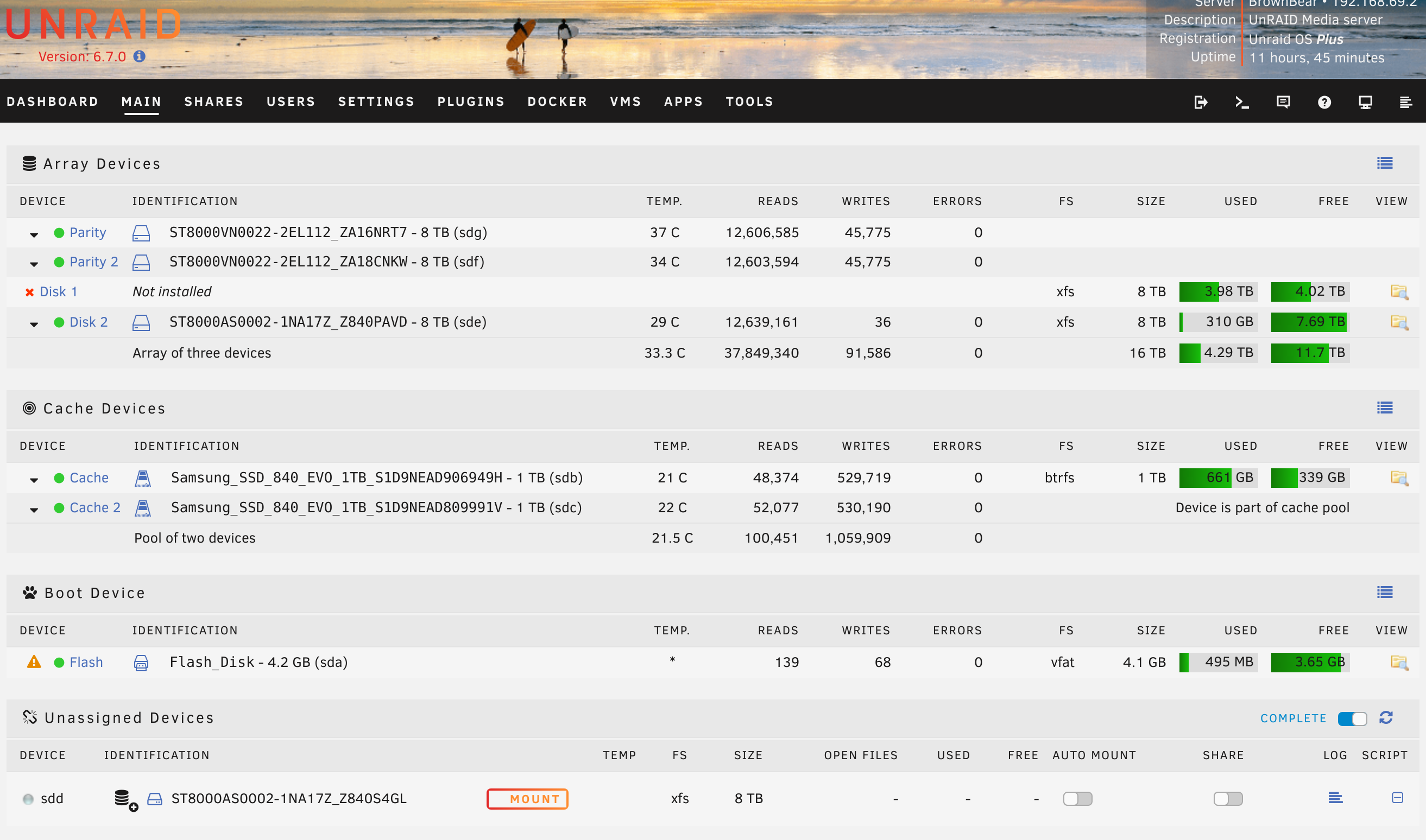

So, the drive has been unassigned, is being emulated, and a parity-check is currently in progress, 3 hrs to go.   I'm still able to access my shares and data.
To the best of my memory, here is exactly what I did:
1. stopped the array
2. unassigned the drive
3. started the array.  The system immediately  began doing a parity check upon starting the array
4. I used the GUI button to "Cancel" the parity check.  Without canceling, the "Stop" array button was not active.
5. After canceling the parity check, I was then able to click the "Stop" button to stop the array.  Unfortunately, it hung trying to unmount shares.  I waited and waited with no progress. I had to hit the physical server reset button to reboot.
6. after system reboot, the array came back up, unassigned drive still in emulated state, services and data running fine, parity check began to run again.  Is currently 80% done.
I really appreciate any advice you guys have.  My UnRAID server has been rock solid, except for the "cable" issue that happens every 4 months or so.  I really need to invest in some better gold plated SATA cables.
Anyway, as requested, here is a zip of my diagnostics... and some screen shots of my main page.
Until I figure out what is going on, I've cancelled the current parity check before it finished.  Things are still running fine with the drive in an emulated state. Going to do some backups to a spare drive.
Thanks.

Unclean shutdown is why it's doing the parity check
May 28 18:10:00 BrownBear emhttpd: unclean shutdown detected
