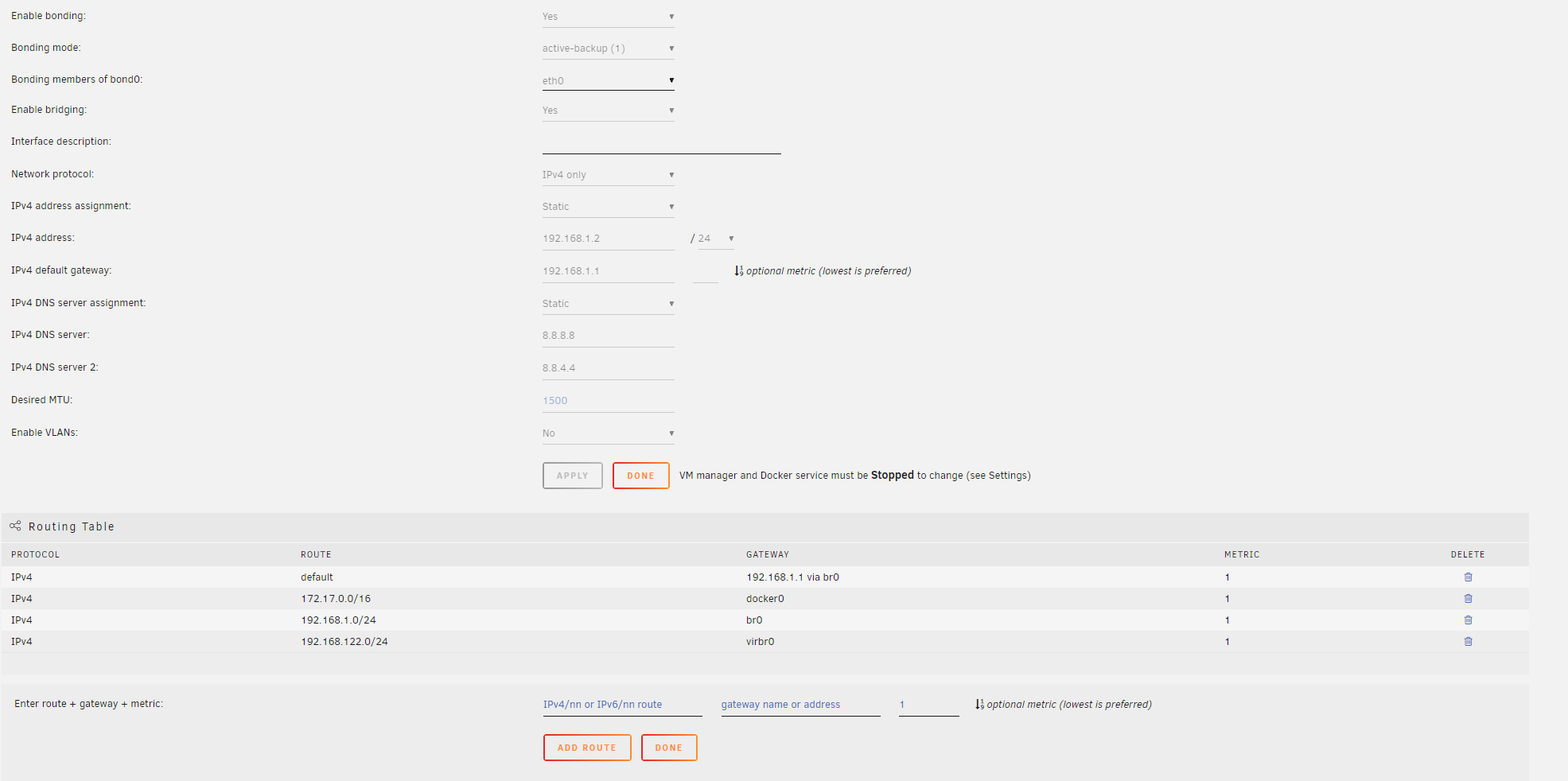

Thanks @tjb_altf4 but it seems I already had that. See the attached image...
I personally needed to delete 2 of my network config files (network.cfg and network-rules.cfg) and reboot, but that was because somehow my interfaces got renamed in 6.7 and I was seeing conflicting information about the active interface.
Note: I had GUI mode to fall back to, so please be careful if you decide to take this route, and as always make backups so you can revert changes.
Adding a static DNS didn't fix my issue either until after that reboot.
