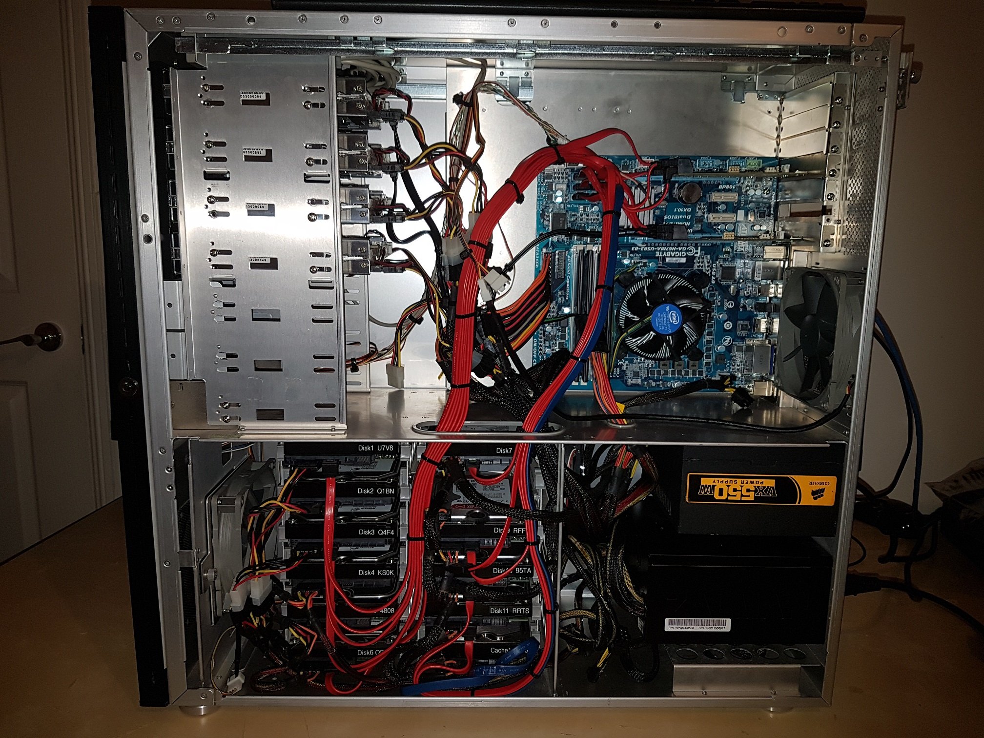

Hey yall,
Looking for advice & suggestions on 16 channel controller cards and if they'll need any special flash, etc.
FYI I'm probably going to change motherboards so I can add a GPU for pass-through. My Hyper-V server is using a Gigabyte Z77X-D3H which has more PCI-E lanes.
Current setup however, using all SATA ports - photo below, I'll probably need longer breakout cables than what would be included anyway.

I ran into problems with crosstalk when I had my cables set that way.it was few years ago, stopped doing it
What sort of symptoms? I've had SATA cables tied like this for years and never had a problem. Just want to know what I should look out for I guess.
drives dropping mainly
