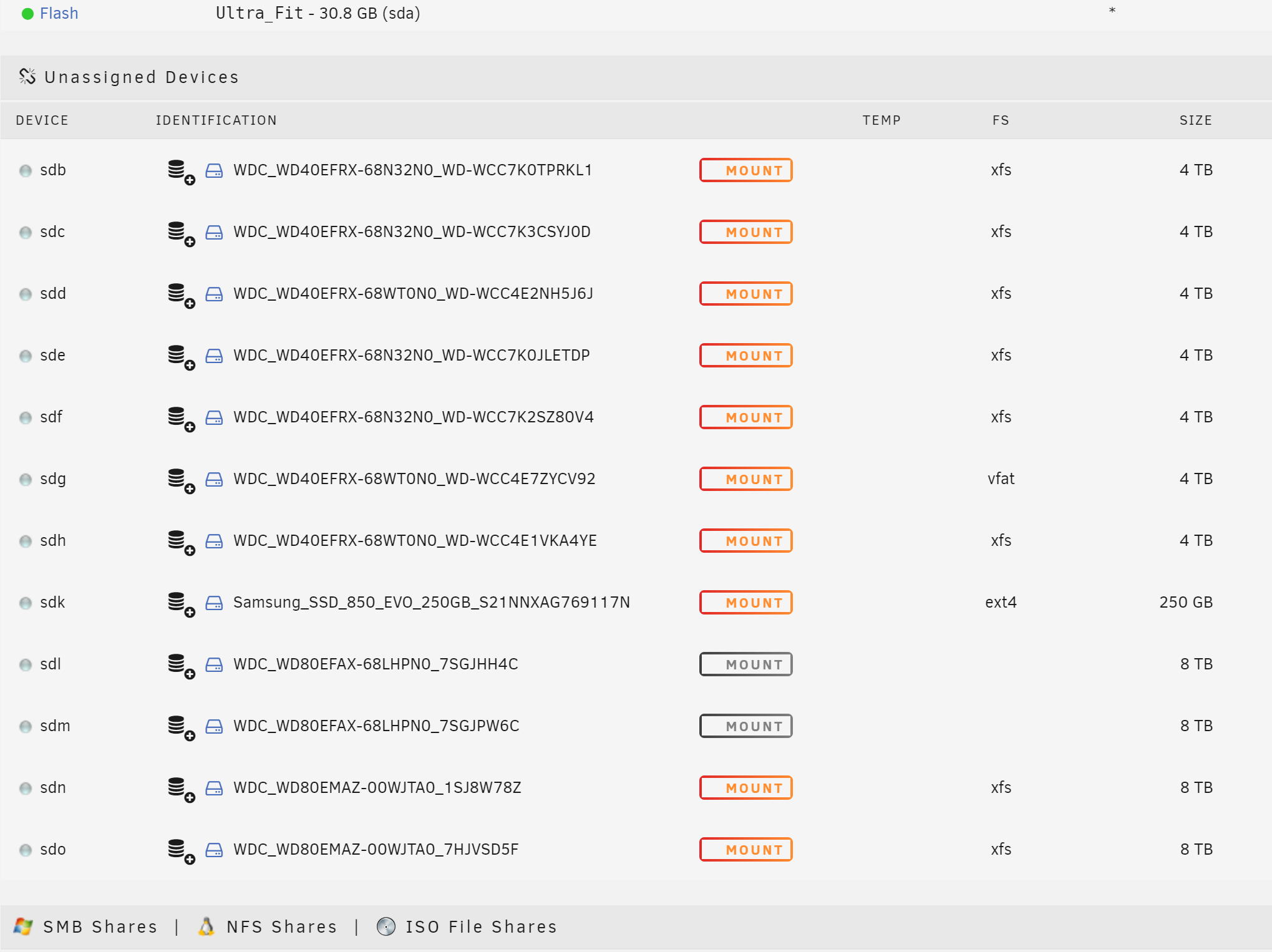

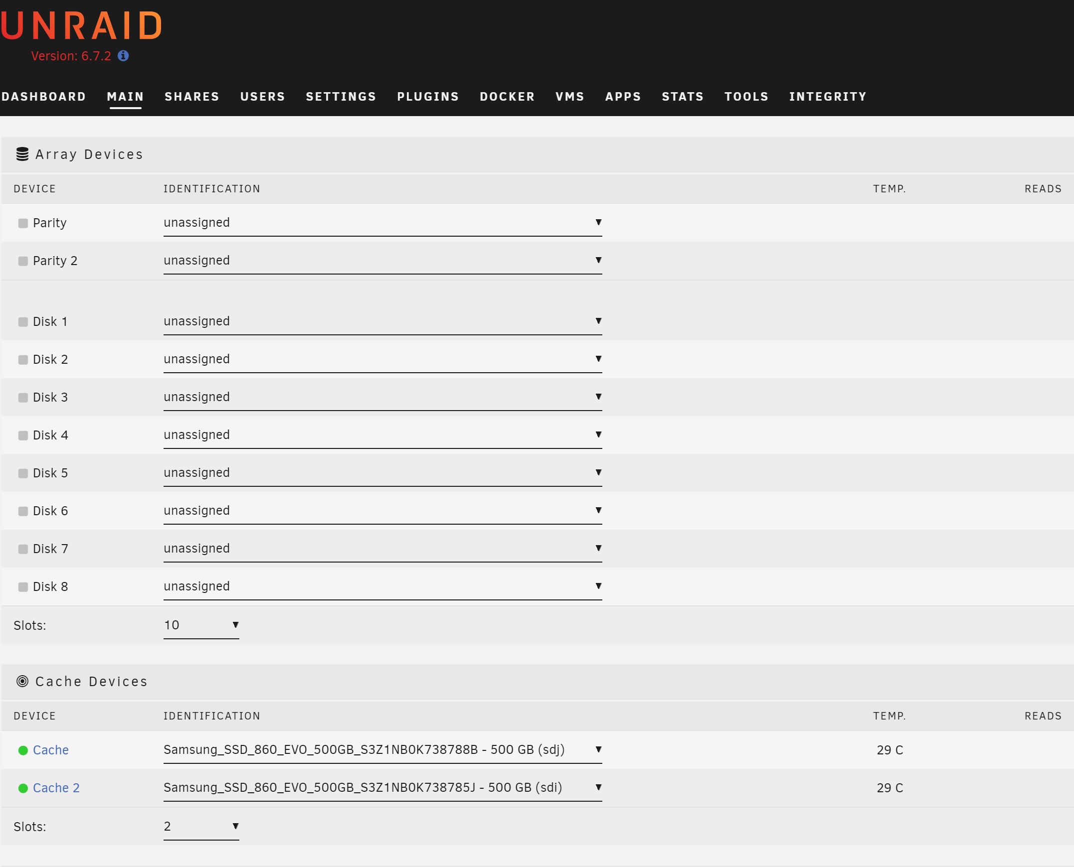

I had multiple power outages today due to bad weather. this caused my unraid server to do an unclean shutdown. After booting it back up my array devices are unassigned. What should be my first steps on restoring my array? (Diagnostics attached)
image.thumb.png.35d22e622f511d7a96753ed8a24898db.pngtidehunter-diagnostics-20190720-1652.zip

The picture you posted seems to show 2 parity drives, problem is with parity2, disk order matters if you need to keep parity valid with reassignments.

Thank you everyone for your input. I've taken jonathanm's advice on assigning all of my disks as they were previously including the correct drives for parity 1 and parity 2. At first glance everything is looking good and I'm running a parity check.
