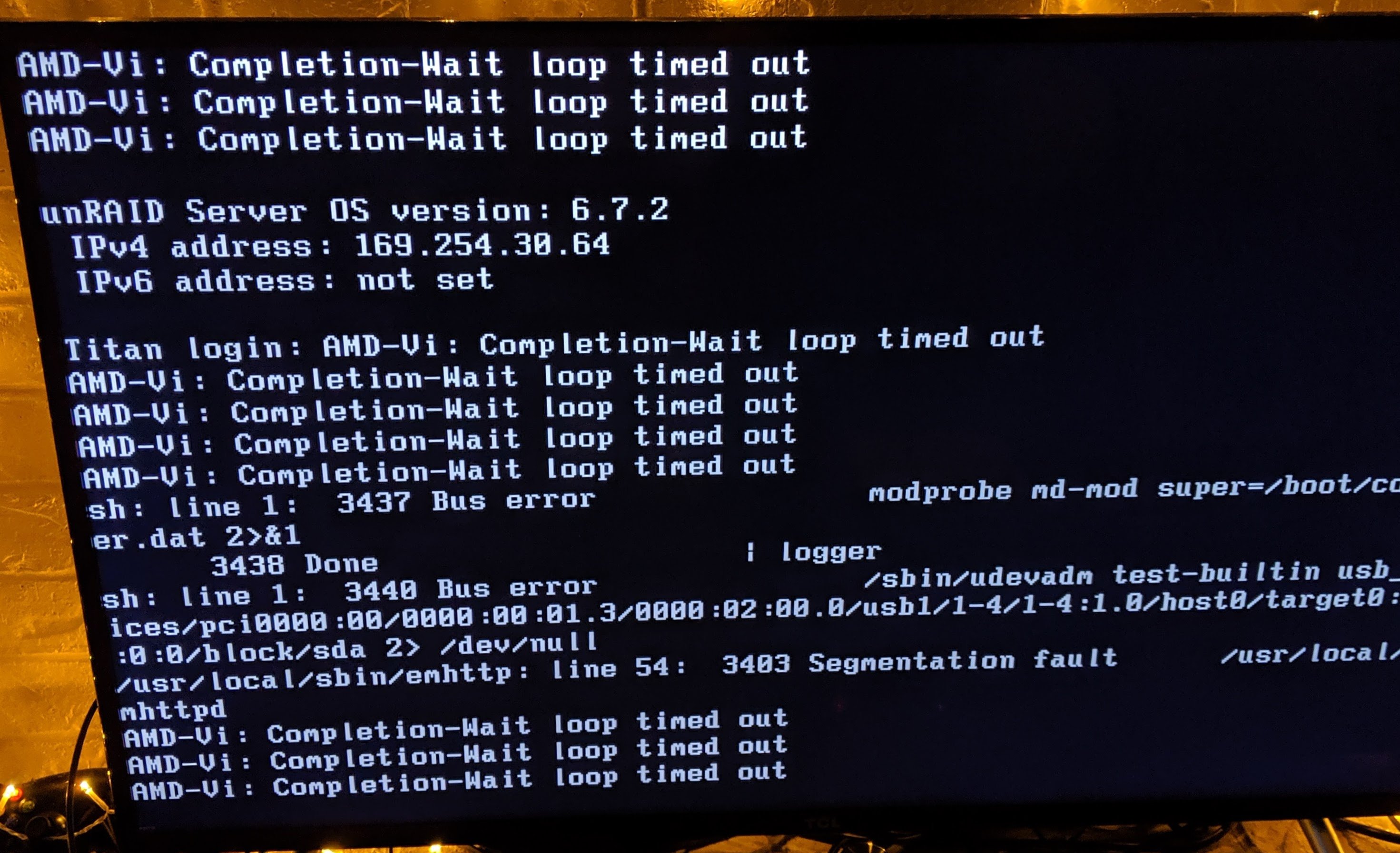

August 2, 20197 yr GPU: (AMD Radeon RX580) Since Ryzen 3700x has no integrated graphics, I had a GPU plugged in the first time I booted unraid. It started but just kept saying "amd-vi: completion-wait loop timed out." Eventually, I just shut it off, removed the GPU and it booted up fine. IOMMU is enabled in the BIOS and SVI is also enabled. I rebooted again, this time, I checked the BIOS to make sure the m.2 ssd is detected; it is but it's not showing in unraid. UPDATE: System boots and detected the GPU only if IOMMU is disabled. Parts: Crucial 32GB CT2K16G4DFD8266 ECC EVGA 650W Supernova GQ 80+ Gold DELL YT674 PRO/1000 VT PCI-E NIC 4-PORT GIGABIT SERVER ADAPTER EXPI9404VT (AMD Radeon RX580 8GB) WD Blue SN500 500GB NVMe Internal SSD - Gen3 PCIe, M.2 2280, 3D NAND - WDS500G1B0C Model: Custom M/B: ASRock B450M Steel Legend Version BIOS: American Megatrends Inc. Version P2.50 (7/25/2019) CPU: AMD Ryzen 7 3700X 8-Core @ 3600 MHz HVM: Enabled IOMMU: Enabled Cache: 512 KiB, 4096 KiB, 32768 KiB Memory: 32 GiB DDR4 (max. installable capacity 128 GiB) Network: bond0: fault-tolerance (active-backup), mtu 1500 eth0: 1000 Mbps, full duplex, mtu 1500 eth1: interface down eth2: interface down eth3: interface down eth4: interface down Kernel: Linux 4.19.56-Unraid x86_64 OpenSSL: 1.1.1c Edited August 8, 20197 yr by TarrifMan updates

August 4, 20197 yr Author Post updated. unraid only boots with GPU (RX580) if IOMMU is disabled in BIOS. Pic shows what happens when IOMMU= Auto or Enabled Edited August 4, 20197 yr by TarrifMan
