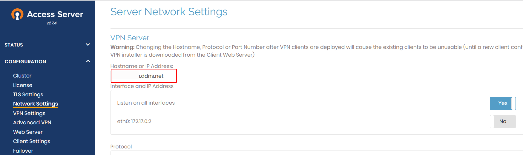

I use OpenVPN and have a No-IP host name for DDNS
Just enter your No-IP hostname rather than the public IP address of your server in the OpenVPN server settings if you have an interest in using OpenVPN.

Is the screenshot from the OpenVPN app in unraid?
Yes, the screenshot is from the Linuxserver.io OpenVPN docker container webUI.
