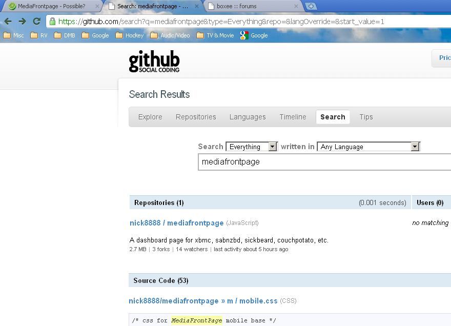

1. Go to github.com
2. Search for "MediaFrontPage"
3. Click on nick8888 mediafrontpage under "Repositories" (see github search.jpg)

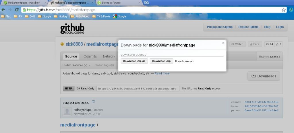

4. Click on "DOWNLOADS"
5. Click on the zip file. (see download mfp.jpg)
@mbryanr
Thanks. I'm not sure why, but I tried 3times the way you posted it and the first 2 times it kept coming up file not found, but the 3rd time it worked fine. Go figure.
