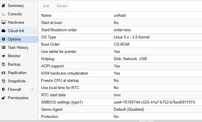

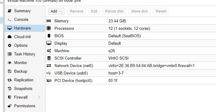

August 18, 20197 yr I followed the ProxMox setup thread by Benson here: I had to set the SeaBios option to get it to boot as I had the same issue found here: Where it couldn't find the boot device. I attached my settings below. And Options: I then added in my PCI Sata controller and hooked up two unformated drives. I only added the controller that doesn't control the ProxMox drive. Adding both causes things to hang. Now when I start my VM I can see in the console that it is trying to boot from disk. There is just hangs forever. My boot order is CDROM, none, none. Why is it trying to boot from disk instead of my USB? If I go to the console after starting, and hit ESC for the ProxMox boot menu, I can then select the USB drive. It is number 3 after the two hdd. How do I make this the default? Edited August 18, 20197 yr by lovingHDTV clarification
