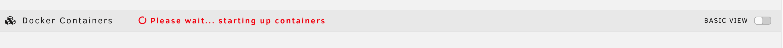

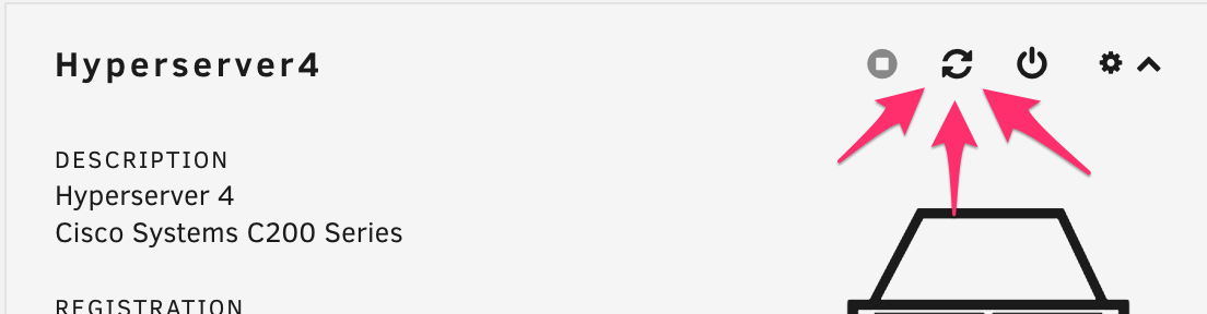

Well, this is embarrassing… 🙄
I just restarted the server using this little button:
…and I got the list of the containers back, I went to the Docker section and got:
Yeah…my bad. 🤤😝
It just needed a simple restart. It triggered parity check, which says it will complete in two days but I got my containers back! ❤️ I can now order new disks and take this server into "production".
