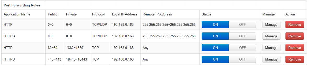

September 24, 20197 yr Author I see this has over 100 views, but unfortunately no feedback. WAN reset last night on my ISP supplied modem/router, and I see the odd port forward rules are back again. At least the other settings and password didn't reset this time. This time I took a screenshot, so perhaps a picture is worth a thousand words! The bottom two are my entries pointing to my unRAID server. The top two are the ones that "magically" appear. They must be inserted/injected programmatically as the UI does not allow entering port 0, or remote IP 255.255.255.255, or duplicating the Application Name. I've tried changing the status to off for those two rules, but saving the change fails, likely due to the "invalid" nature of the rules. I tried entering a port blocking rule, but again no luck due to invalid port 0. What risk does this pose to my unRAID server? Edited September 24, 20197 yr by beverage
September 25, 20197 yr Hi, I don't know why that rules are automatically created: remote ip 255.255.255.255 is a special ip address that means "this network" (in other words the local network). Port 0 is a special port that means that it is up to the operating system to find a suitable and not in used port (in case of applications that use bind() for example). A socket connection requires a source port and a destination port: when a packet is transmitted from the source it contains both the source and destination ports, so when the packet reach the destination, it knows the correct endpoint. So by merging these definitions, this should mean any address of the local network (remote ip 255.255.255.255) can request a connection from port xx to port xx, where port xx is chosen by the os (not too much sense for me, especially for the destination port.., it should be related to fragmented packets). Edited September 25, 20197 yr by ghost82
September 25, 20197 yr Port "0" is a reserved port, and there is nothing on Unraid listening or using that port (otherwise it would violate the RFC standard). The address 255.255.255.255 is the broadcast address and is not routable. An ISP will never forward on such an address. In other words it is an unreachable destination.
September 25, 20197 yr Author Thanks for the feedback. I spent a considerable amount of time chatting with my ISP tech support about it, and it's nothing that they're aware of. They suggested it was added by a service running behind the firewall (i.e. this would mean the NPM docker container running on my unRAID box) - not likely, but what more could I expect from the ISP tech support? I also tried contacting the modem/router hardware manufacturer but, without even considering the question, they punted me back to the ISP because the ISP's typically load up customer firmware. In the NPM thread, I mentioned a NAT reflection issue related to reaching a website hosted on my unRAID box from a machine on my LAN. I was unable to find any NAT reflection type settings in the modem/router. I'm beginning to think these odd forwarding rules that automatically get added are some kind of workaround related to NAT reflection. Does that make sense?
September 25, 20197 yr To be honest, these settings look very odd to me. Does your router have a setting for NAT reflection, also called hair-pinning or NAT loopback?
September 25, 20197 yr Author 12 minutes ago, bonienl said: To be honest, these settings look very odd to me. Does your router have a setting for NAT reflection, also called hair-pinning or NAT loopback? I was unable to find any settings in the router for NAT reflection / hair-pinning / loopback. This is why I'm now wondering if these odd rules are a way to achieve the same functionality as NAT reflection?
