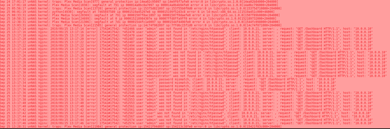

September 25, 20197 yr I'm seeing a lot of these errors in my logs and I'm not sure what they mean or what I should do. Is this something I can safely ignore? unnas-diagnostics-20190925-1749.zip
September 25, 20197 yr Someone is trying to login to the server with user names of admin, Administator, administrator, root, user, etc Have you got unRaid's webUI accessible to the outside world?
September 25, 20197 yr Author no it shouldn't be accessible outside... I have changed the port for my webUI to http port 81 and https 443 but I don't have it port forwarded. Is there any way I can check?
September 25, 20197 yr What system is 10.0.0.10 on your network? It originates from thereSent from my NSA monitored device
September 25, 20197 yr What system is 10.0.0.21? It tries continuously to access the server with the wrong credentials
September 25, 20197 yr Author 10.0.0.10 is the internal ip address of my unraid server. 10.0.0.21 is my parent's PC. They are not tech savvy at all and I doubt they would know how to connect or try to connect to the server. I asked them if they were using the PC at 13:17 and they were but they were just transferring files through SMB fileshare to my unraid server that I had already saved credentials for. I asked if they had tried to enter in any username/passwords but they denied anything.
September 25, 20197 yr 7 minutes ago, bonienl said: What system is 10.0.0.21? It tries continuously to access the server with the wrong credentials You just gotta be right all the time and correct me
September 25, 20197 yr Maybe there is something running on your parents PC in the background. The log shows this as the source of the access attempts.
September 25, 20197 yr Just now, Squid said: You just gotta be right all the time and correct me I didn't notice your answer because we were typing at the same time
September 25, 20197 yr Author Okay I suspect that there could be a virus on my parents PC that could be trying to connect to my unraid server. Any idea about the plex related errors? Is that also connected? Sep 25 13:28:31 unNAS kernel: traps: Plex Media Scan[21984] general protection ip:15421f94d097 sp:154213c38fe0 error:0 in libcrypto.so.1.0.0[15421f83c000+204000]
September 25, 20197 yr The plex errors come from the wrong crypto library installed. Remove the DevPack plugin, it installs the wrong version.
