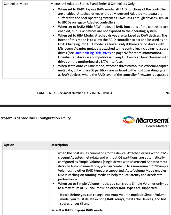

May 21, 20215 yr Author On 12/29/2020 at 8:57 AM, methanoid said: @DoeBoye I wish you'd responded to the last post here, to know which mode you had it set to. I wonder if Simple Mode is like HBA mode but even dumber? Are all your disks connected to the Adaptec or some to mobo? What sort of parity speeds do you get from it in that config? I'm also v curious to know how it would be in a X4 slot (4GB/s split 15-24 ways would still max out spinning HDD speed). How many extra seconds does the controller add to boot time? Hello! So Sorry about the extended delay on this question. I must have missed the email that there was a response to this thread! My 72405 is set to 'HBA' mode. See screenshot for what the manual has to say. To me, it sounds like 'HBA' is the correct choice for Unraid... As for parity speeds, hard to say. Some of my drives are ancient, so slow things down quite a bit, but I have seen speeds range from low 90 MB/s to maxing out my fastest drives. With all 24 ports occupied, I believe the technical max speed would be 4800 MB/s / 24, (Based on this very thorough post) but I don't believe I've ever seen 200 MB/s during parity checks. I have 14 sata ports on my board, but 4 of them are Marvell and I learned the hard way a few years ago that Marvell and Unraid do not play well together. So 10 sata ports from the board, and now that I'm experimenting with Chia farming, all 24 ports on my controller are occupied (I actually bought an expander to increase the number of available drives, but I'm having some issues getting it running... Hopefully my foolishness, and not a bad card... TBD ). In a 4x slot, your max speed would be 2400 MB/s, so you might be limited a bit on parity checks, but for regular usage when not all drives are being read, I'm sure it would still be decent. Boot time: Hmmmm... Good question. Boot time has always been slow for me, but if I had to guess, I'd guess another 30 seconds or so? I hope that helps somewhat. Apologies again for the delayed response :).
