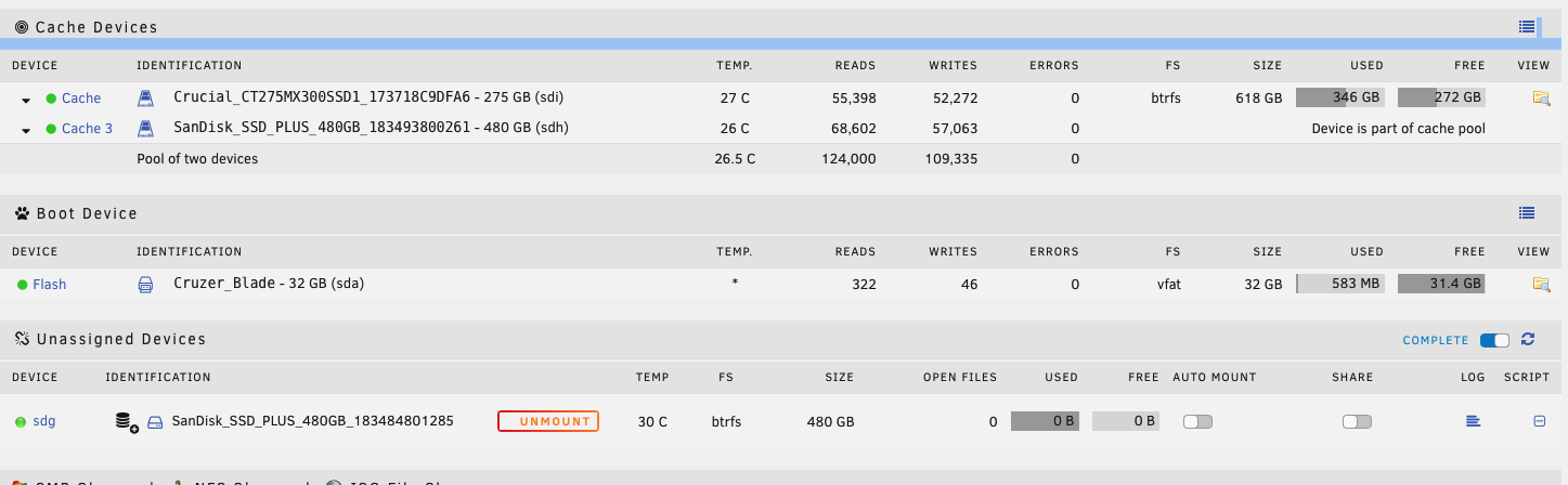

Hello,
I had an issue with an SSD that is part of my three drive cache, I think due to cabling, lots of CRC errors
Reseating all the cables and booting back into rescue mode I ran Btrfs scrub on the device and it corrected some 1,000,000 errors correctly, no failed repairs.
Rebooted into unraid full and it for some reason then ran a resize for two hours then settled down again.
Finally I have a situation where the actual Btrfs seems fine although in need of a balance, but unraid thinks only two of the three disks are actually in the cache.
Smarctl -t on affected SSD is showing nothing.
Not quite sure how to progress, any ideas?
Thanks

Stop the array, if Docker/VM services are using the cache pool disable them, unassign all cache devices, start array to make Unraid "forget" current cache config, stop array, reassign the 3 cache devices, re-enable Docker/VMs if needed, start array.
