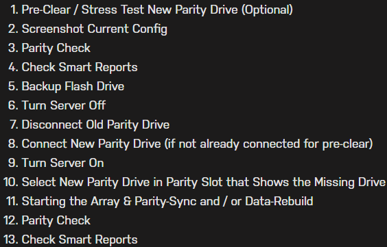

  1. Pre-Clear / Stress Test New Parity Drive (Optional)
  2. Screenshot Current Config
  3. Parity Check
  4. Check Smart Reports
  5. Backup Flash Drive
  6. Turn Server Off
  7. Disconnect Old Parity Drive
  8. Connect New Parity Drive (if not already connected for pre-clear)
  9. Turn Server On
  10. Select New Parity Drive in Parity Slot that Shows the Missing Drive
  11. Start the Array & Parity-Sync and / or Data-Rebuild
  12. Parity Check
  13. Check Smart Reports
Thanks again for the help!
