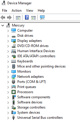

Sound card now working, had to renable "both" on the ACS override, not sure what that does vs downstream but there ya go
Well, I said the sound card was working, it's passing through but then isn't seen in Windows, but nor is the Vega graphics card (for HDMI)
Any ideas?
