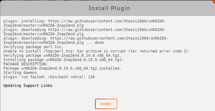

@steini84 I received the below error when updating to stable 6.8.3 ...any suggestions? going back to 6.7.2 for now.
@steini84 I was able to get it working by deleting the old /boot/config/plugins/unRAID6-ZnapZend folder and downloading a new one.
k still running into some issues...-bash: /usr/local/bin/znapzend: /usr/bin/perl: bad interpreter: No such file or directory when I run znapzend --logto=/var/log/znapzend.log --daemonize. below are some logs.

Perl install is failing. Will look into it tonight [emoji123]

Should be fixed now

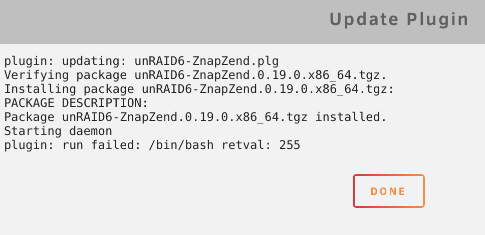

I have endless problems with this not deleting snapshots when it's supposed to.  So I thought I'd just update in case it refreshes something.
However, I just get the below - first plugin error I've ever had.  Is it because I'm not running the beta?
No I accidentally pushed a broken update , but it’s correct now
Coolness.  Thanks for that.
