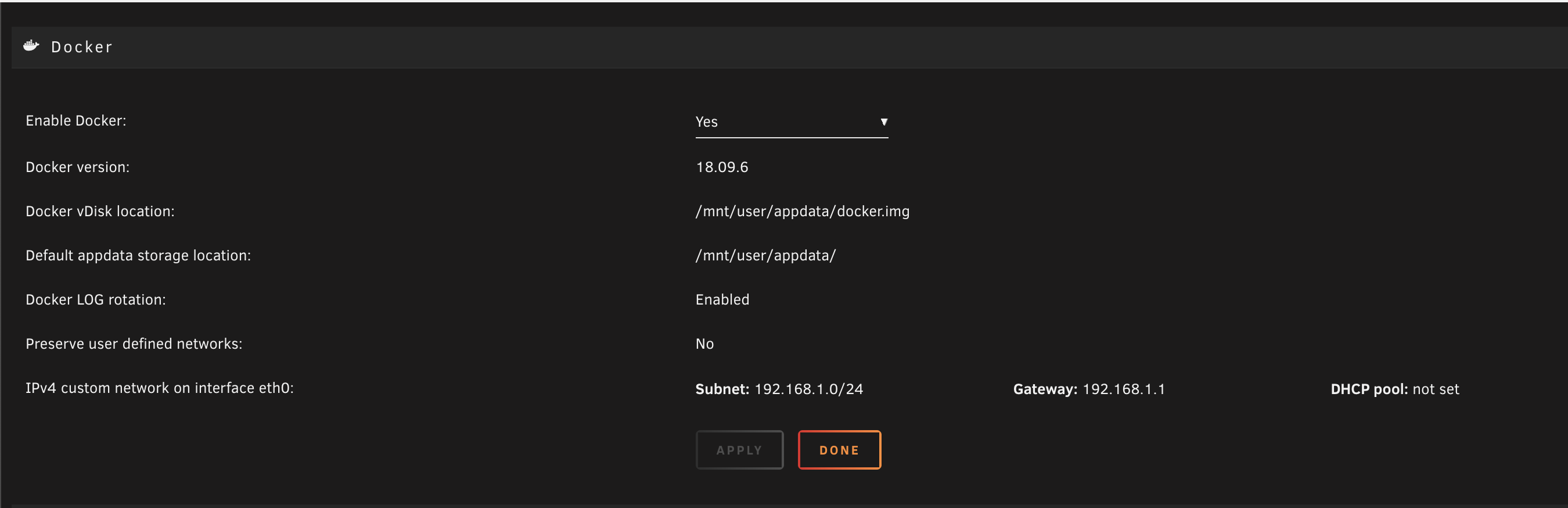

19 minutes ago, midasisking said:
need to rebuild the image due to a bug.
Happens on occasion (why not sure).  Just delete it and recreate it, then add your apps back in via Apps - Previous Apps

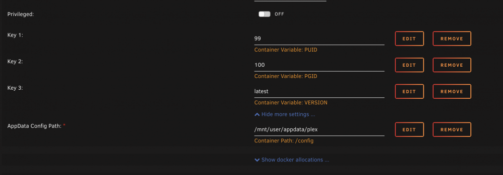

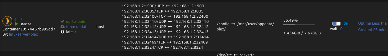

So currently I am unable to get Plex to load past the main logo screen and am unsure of what to do. The cache drive was recently installed and then I modified the appdata share to be cache preferred. Now I think there is something wrong with my appdata share or the docker settings for Plex but I think I set them in the same way as is shown on popular tutorials. And I updated from 6.6.7 to 6.7.2.

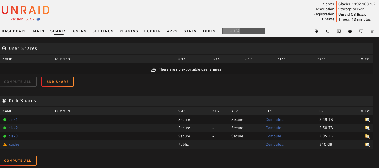

Did everything move to cache?
Check by doing “compute all” under Shares. Post a screenshot
@bonienl Well I hit Compute All, waited a little while, but now its saying there are no exportable user shares. Not sure if that just means its still computing in the background though...hope thats the case.

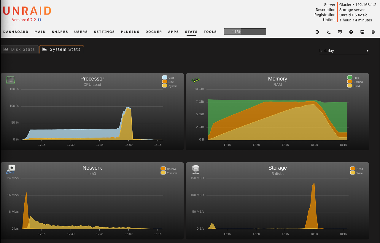

added stats screenshot, fixed a typo.

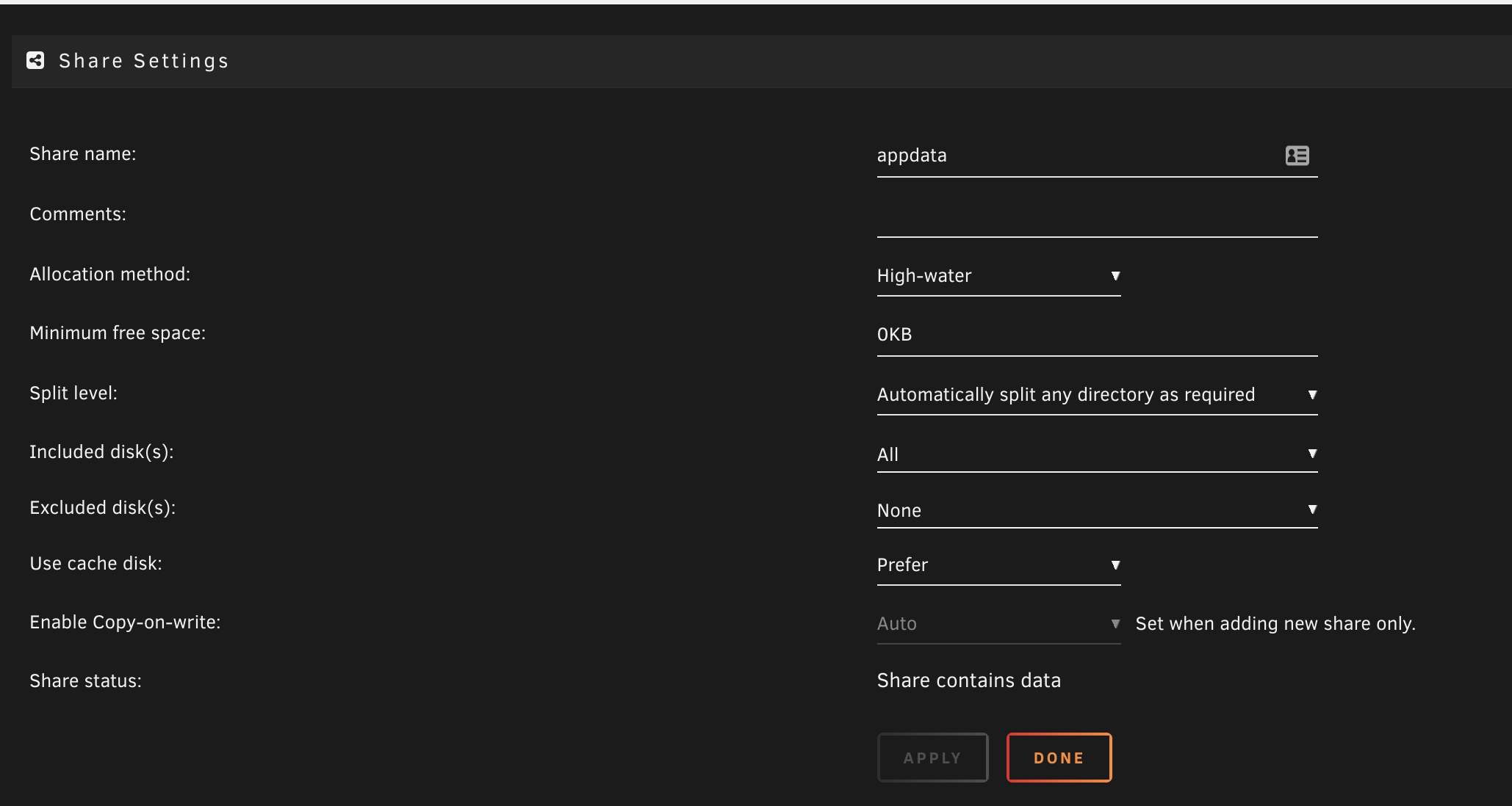

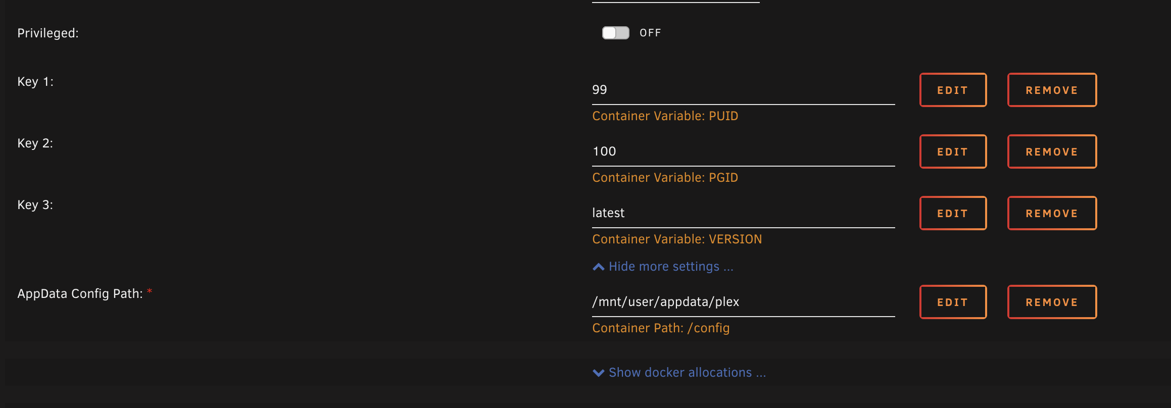

Should my volume mappings for plex and other docker containers be set to /mnt/cache/appdata/[appname]? The share that all the data is on, appdata, is set to cache preferred right now and it appears that all the data is in sync between the array and the cache.
Now I am also unable to get Plex to show its web UI and the docker is basically constant at 30% CPU usage which is way higher than normal.
That's the same place I map all of my Dockers. Actually mine is /mnt/cache/system/appdata/DockerName ,but you get the idea like yours.
and for
appdata I have Shares setting set to "Cache Only" to keep all my Plex Docker files on the SSD/Cache Drive.
When you moved your appdata from your array to your cache drive did you go back to a known good database for plex? If you didn't it's still using the corrupted database which would be why it isn't working.
@Storm King I think that was what was happening and since I didnt have backups from long enough ago to be sure it would be safe I ended up killing the database and rebuilding it all from scratch. I will be making fresh backups once I confirm its all working again.
@kizer Why do you use cache only instead of prefer? Do you backup all that appdata somewhere else to guard against your cache drive failing? I am just setting up a cache for the first time here so I want to do it right at the onset.
@midasisking Like many I use my SSD for Speed and to reduce the need to spin up my array for Docker Files.
All my Media is on the Array and I want Plex to display my Library instantly vs waiting a disk to spin up.
As for backing up my Dockers I simply use the CA Backup script and UnAssigned Devices to a portable drive connected via USB.
@kizer Thanks for that, that's interesting. I certainly want to see better start up times for Plex in general and am looking forward to getting all my drives spun down during the majority of the day but thought that I ultimately needed those files on the array for safety. Do you know if I have the share set to Prefer if itll use all those files on cache before spinning up a drive? Or do I need to really cut over to cache only to get that kind of change?
Prefer basically tells your system to use your SSD to store the files unless it starts to get full then use your Array and should move them back when there is space available. I like to side on caution and make sure all my files stay on the SSD just in case to make sure nothing goes sideways. Like Possible Corruption.
