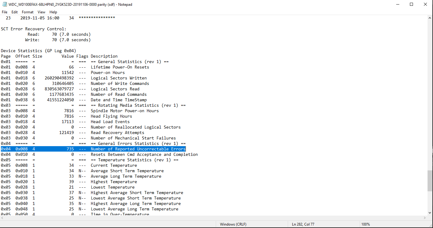

The parity log definitely shows errors, I'm still learning to read these files and unfortunately I can't tell you how serious this might be but I did google it here maybe someone can add more to this for you. I've attached an image of the text file for the parity disk so that you can see where the error can be found within the file based on the position of the window slider.
Edited by Dissones4U
typo
So RMA the Drive?
As I mentioned earlier I'm by no means an expert, but my gut feeling is yes, request the RMA. After googling "reported uncorrectable errors" I found a link to backblaze where I've gotten good information in the past. This backblaze article discusses the Big 5 smart data points. Then I found a second source here which seems to provide consensus regarding these data points. I'd suggest reading up on this error and then deciding how you want to proceed...

It's a disk problem, you can also run one or more extended SMART tests and it will likely fail one sooner or later, since these type of errors can be intermittent.
I ran an extended SMART test prior to posting and it came good like I said. Good to know those can be intermittent
