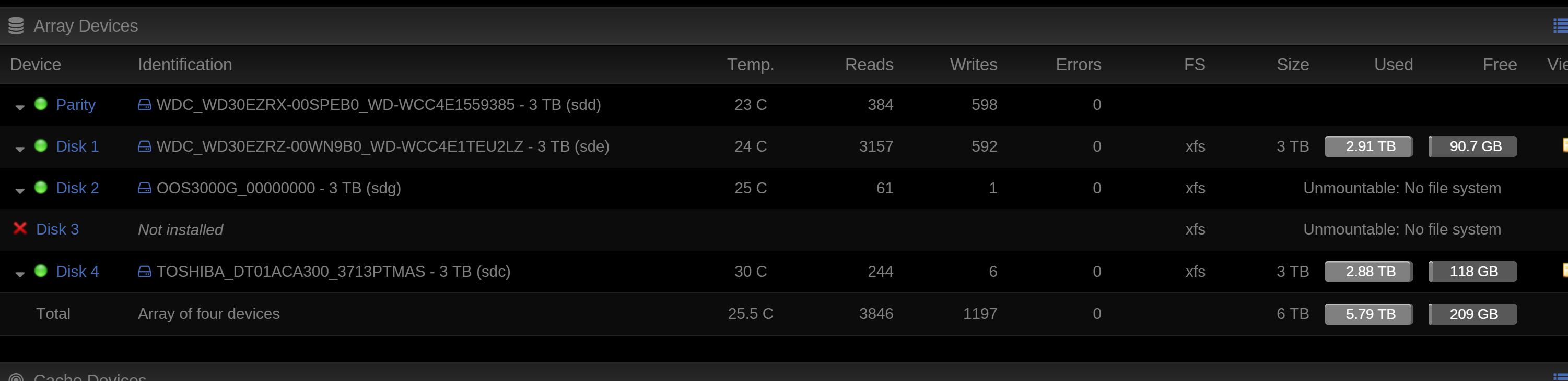

This is my situation
Disk 2 is the drive i repaced the first day
the other one should be the disk i tried to upgrade

Check filesystem on both disks, but this isn't normal, something else is going on, likely hardware related.
