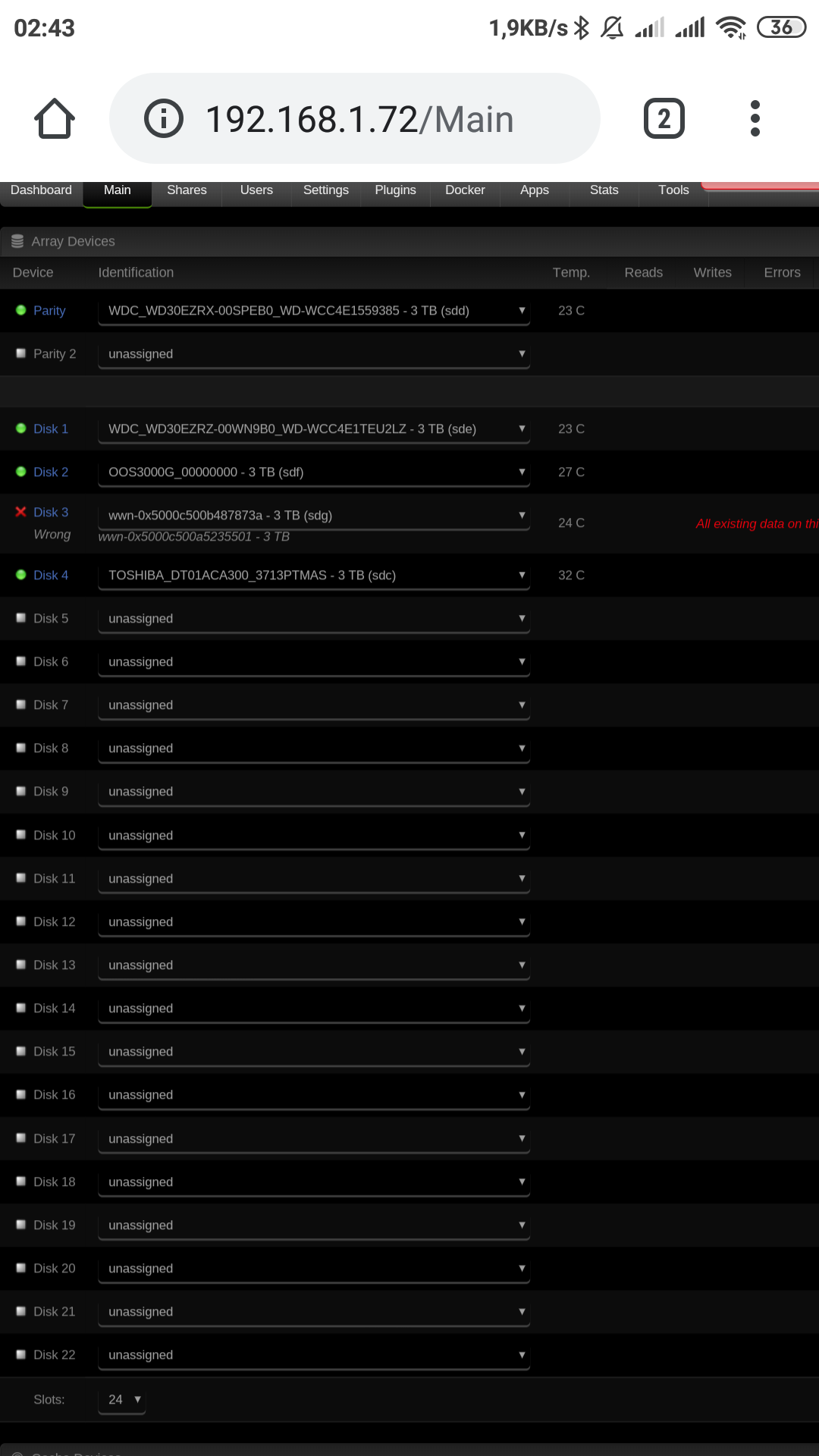

Ok, today I tried to put back the new 3tb drive, everything went well until the end of the rebuild, the new drive give me the same error (unmountable :no file system) so I stopped the array to try to fix the file system, but for no reason my drive have a different name than before, how I should procede? Screenshot_2019-11-22-02-43-59-642_com.android.chrome.thumb.png.13e8f61ea6e963ac04d44ae24b6d72e4.png
Device can't be on a controller that changes identification, Unraid requires disks identification to remain the same, or it will consider it a different disk.
The new drive is connected to the motherboard, but it changed the name after I stopped the array, i have to create a new configuration? Or I have to start the array in maintenance mode and fix it's file system
That shouldn't happen with the onboard ports, please post current diags.
I have two drives with the same ID, in fact the first time I plugged the new drive he got that weird name, but is not supposed to change after I stopped the array,right?

I don't know what kind of device that is since there's not even a SMART report, but you don't want to be using that with Unraid, if it changes ID without warning it won't work.

It's not being detected as a standard hard drive, try to get and post a SMART report.
OK, I see the problem now, disk2 has the same ID as disk3:
Nov 21 18:06:38 Petere kernel: ata10.00: ATA-10: OOS3000G,             00000000, 0001OOS1, max UDMA/133
Nov 21 18:06:38 Petere kernel: ata9.00: ATA-10: OOS3000G,             00000000, 0001OOS1, max UDMA/133
You can only use one of these with Unraid, and these are no standard Seagate drives, maybe white label?

Yes, white label, is that the problem?
In this case yes, since they have the exact same ID, they don't even have a valid serial number, Unraid requires that each device has a different ID, since that is used to track them.
