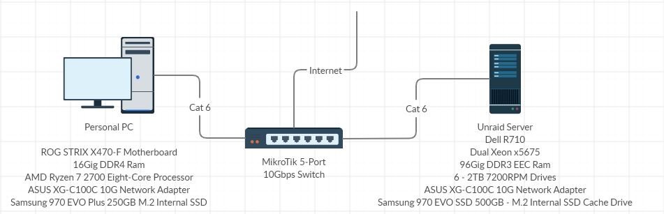

Hello Everyone! I'm trying to setup my network (new unraid install) and can't seem to locate this bottleneck problem I'm having. I've attached an image of what my setup currently is. For some reason I cannot hit a 10gbit transfer speed. I know there is some overhead but I can't even come close. The most I've ever seem testing was 200-300mbit up or down. I created a temp share with all files going to the cache. I have even tried to do a direct connection from my pc to the server itself and get the same results. I have a feeling it might the server itself not being able to move that much data at once.
 If anyone has any ideas I can look over to try and resolve this I would be greatly in your debt :)

Ok here are the iperf results. Now I did it the way I had it setup prior and the way you suggested by eliminating the switch. Both setup results were the same. First result is the 10gbit connection between my pc and the unraid box. Second result is on the 1 gigabit connection.

8 hours ago, 1812 said:
push it higher. I had to go to 100 threads to hit 9.x Gbps but at the same time, on 10 I hit 7.xGbps so you do have some other issue... how long are your cat6 runs? are they just cat6 or 6a? bend in any cables?
I did that as well with the same results, sorry I should have posted that. The cat6 cable is/was approx 35ft long, straight shot from my pc to the server in a crawlspace, no major bends. I installed it personally so I know how it was ran. I did take a different approach last night and ditched the nic cards and went with the Mellanox fiber cards and the OM3 Duplex Fiber Optic Patch Cable with the same results leading me to believe that it has to be my hardware. I don't know if the Dell R710 mother board or pci is even able to do gigabit speeds.
8 hours ago, johnnie.black said:
You should be able to hit 10GbE or close with a single iperf thread, I get around 9Gbits, and if not a single transfer will never be that quick, it's usually not faster than a single iperf thread, unless you plan on doing multiple simultaneous transfers.
D:\temp\iperf>iperf3 -c 10.0.0.7

I though the same thing, I've seen multiple YouTube videos on the same setup I have (different hardware) and able to transfer one file in windws at almost 10gbit speeds.
Ok, pinned it down to being my personal PC. I move the fiber card from my PC to my sons PC and now I can push 9.5 gbit up and down. It makes no since since my hardware is better than his and much newer, but I guess it doesn't really come down to that in this case.
So, that leaves just one thing, my windows install/settings. Do you guys think it's worth doing a fresh install of windows or are there any settings I should be looking at.
Thanks guys.
