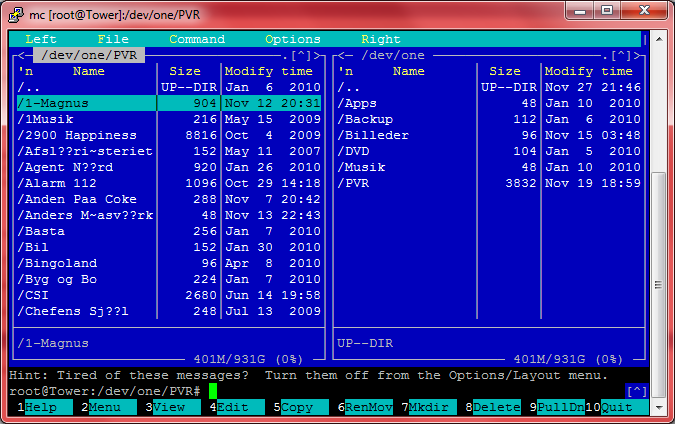

That did mount the drive - and I do see some data using MC (still not any of the photos I would have liked to). But I'm a little unsure about what was on disk6 and what on diak1, so maybe most of what I do not see here is on my old sleeping disk6.
Now I need to share my newly mounted /dev/sdc1 on the net so I can copy stuff from it - how is that accomplished?
I mounted it to a folder like this: mount /dev/sdc1 /dev/nia
I'm a little confused. When the disk is viewed through mc on a mount like below, it appears as if it has all the data (I believe). At least it shows 401M/931G in the bottom of MC, and I can LS a lot of files, that seems like it could be all(or at least many) of the original files  ;D
Interestingly, when I look at it as disk1 as it is shared trough unRAID, it contains the top folder structure and a few files that seems like recovered data - 18GB in all.
Don't know if that means anything. The ls-output and the directory seen from the disk1 share attached.
two-different-views-of-disk1.zip
Having looked at things a bit more, I have a modified Plan B - meet Plan C:
It appears that my data from disk1 is available (as per mc screenshot attached here and ls output from earlier). However, still it's a different story entirely when the drive is mounted through unRAID, where only some lost&found is displayed.
I'm thinking: I stop the array. I manually mount disk1 and add my 2TB disk in stead of the disk6, that never got the right data anyway after it converted from the parity. Then I could do a simple file system copy of the files disk-to-disk.
I still really would like to be able to take some of the files out from the disks and see if they are actually any good. How can I accomplish that? Can I mount a standard external USB disk? Map it from a Win-machine. Map a win-drive from Linux/unRAID console?

If you Stop the array and manually mount the disk, are saying it's contents are different?
Yes - that is what has me really puzzled as well.
If you look at the attached screendump from mc in the recent post (or the ls-output before that) it sees all(or at least many) of my old files. This is with unRAID stopped.
If I access Disk1 throught it's unRAID share (unRAID started), I get a different output. See attachments to this post. The impossible - possible...

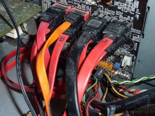

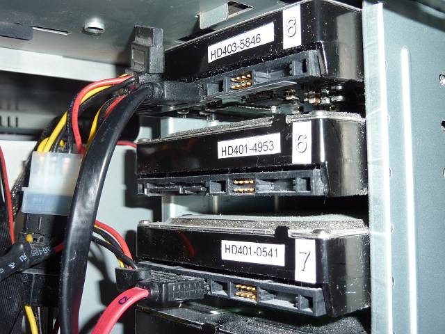

OK - I got the meaning of the devices page thoroughly screwed up. I thought that it was a logical scheme that had no real meaning in the physical world. And from that logic I came up with the plan B/C.
I have however already made a pretty thorough labelling scheme. As can be seen from attachments, I have
- physically labeled the disks with the first part of their identifier and the last part of their serial number as it is seen on the devices page
- physically labeled the cables 1-4 and R1-R4 matching the SATA/RAID ports (not all the numbers visible on photo)
It was merely to keep track of what was where, but I guess it makes a lot of sense in this respect as well.
So you suggest to re-organise the devices in the devices page to map to the actual physical ports (where now, I would have SATA4 connected to disk8 and RAID3 connected to disk6)
So, for example:
Physical SATA1 --> Disk1
Physical SATA4 --> Disk4
Physical RAID2 --> Disk6
Physical PATA1 --> Disk9

I did both look at the disk when the array was stopped (mounted manually) and started - with different results.
If you look at the mc attachment in my post above here: http://lime-technology.com/forum/index.php?topic=9135.msg87820#msg87820 it displays what can be seen when the array is stopped.
My post http://lime-technology.com/forum/index.php?topic=9135.msg87847#msg87847 has the look at disk1 as it is shared when unRAID is started.
There is also a post here: http://lime-technology.com/forum/index.php?topic=9135.msg87847#msg87847 where output from "ls" in a console is reported in array started and stopped mode; yielding different results also. When unRAID is stopped, the disk reports my contents.
Therefore, I'm concerned about getting the data out as they are seen when unRAID is stopped, as I would expect unRAID when started to not see the data on the disk.

If I were in your shoes, I would:
1. Temporarily disable any add-ons (such as unmenu, etc) you might have.  (why? because it will confuse the communication between you and me.)
2. Cable everything up in a logical manner, make sure the Devices page reflects that.
3. Remove the parity drive by simply removing it's power connector (to simplify things).
4. Now, boot server and observe that array probably won't start because of the changes on Devices page (if it does Start, then Stop it).
5. Now go to webGui devices page and look at all the entries there.  You will see an "identifier" inside parenthesis, e.g., "(sdb)" and "(sbc)".
6. For each data disk in the Devices page list, you are going to run reiserfsck from a telnet session as follows:
reiserfsck /dev/sdb1
(What you did was use the identifier, prefix with "/dev/" and "1" suffix.)
Answer 'Yes' to the prompt.  If any disk reports errors, the output of 'reiserfsck' will tell you what to do next;  usually it's to re-run with the '-rebuild-tree' option.  Do this for every data disk.
Whatever you get for the hard drive assigned to disk1 is what you get - if reiserfsck can't recover a file, then sorry to say, it's gone.
7. Now power down, connect parity, and power up.  When array comes up, again, it probably won't start.  So from telnet you have to type:
initconfig               (answer Yes to prompt)
Now go back to webGui & click Refesh.  You should see all drives with "blue dots" next to them.  Now Start array and parity sync should start up.
After you get this far, then we can talk about uprading your disks to larger ones.
