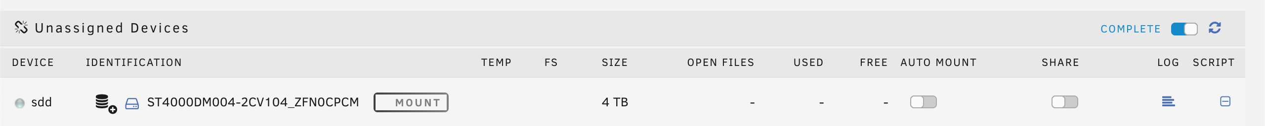

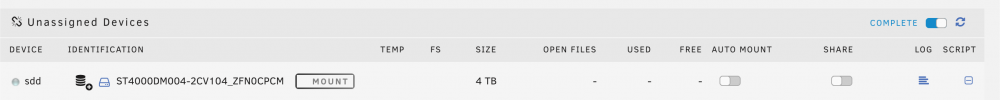

December 7, 20196 yr Hi, I'm new-ish to unRAID but i cannot get my 4TB Seagate drive so I can view and then copy the files on it to my array. When I go to mount the drive, the "Mount" option is greyed out. I have 3 partitions of it as I converted my Windows 10 computer to unRAID and I still need to copy the media on this drive to the array. I have used the Unassigned Devices Plugin and it worked with my 240 GB SSD, but not with this drive. Please help! Thank you.

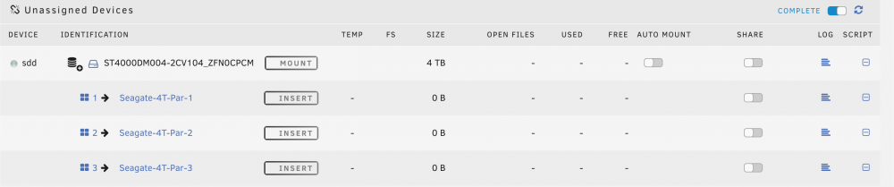

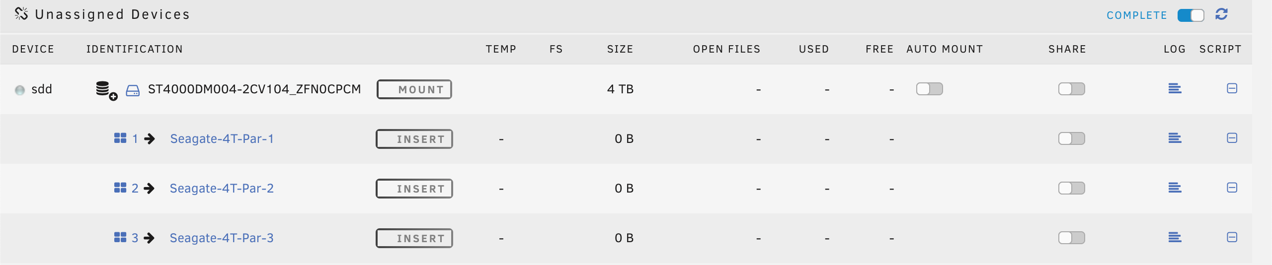

December 7, 20196 yr Press the black + button on the lower right of the black disk icon below the "T" in IDENTIFICATION to show the individual partitions.
December 7, 20196 yr Author 3 minutes ago, testdasi said: Press the black + button on the lower right of the black disk icon below the "T" in IDENTIFICATION to show the individual partitions. I have seen the parititons before, but the actual drive cannot be mounted to be able to be viewed from any other device. All of the options are grayed out and there is nothing when I click on the log on the right side.
December 7, 20196 yr Author Just now, dlandon said: The file system on the disk is not recognized by UD. If I recall, the file system should just be NTFS, I don't see why it shouldn't work though. 2 minutes ago, testdasi said: I suggest perhaps you post in the UD support topic. I haven't seen this before. Okay, do I create a new post or can I change this topic?
