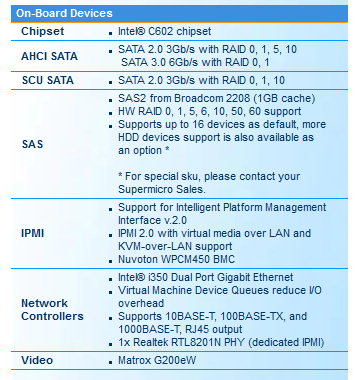

I was looking at the syslog looking to find an indication that the Unraid Linux installer has detected any network devices and installed the drivers for these device. I did not find any indication that it did.  I also looked for and at the ifconfig.txt and ethtool.txt files both of these files are in the system folder of the Diagnostics file.
Here is the site I found about your MB.   I have done a screen capture of  a portion of the spec's.  Note what it says about the Network Controllers.

From my limited knowledge of server motherboards, this IPMI function is quite common.  I would suspect that the Network controller for this function is totally and completely unavailable for use by any OS.  If you look at the screen capture you will see that there is a Intel network controller that drives two other network ports on your MB.  You really need to download that manual and give it a read!!!
