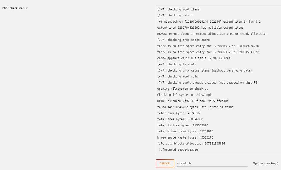

So I started the array in maintenance mode and checked the btrfs filesystem.
I like that line that says cache appears valid but isn't.
WTH?
