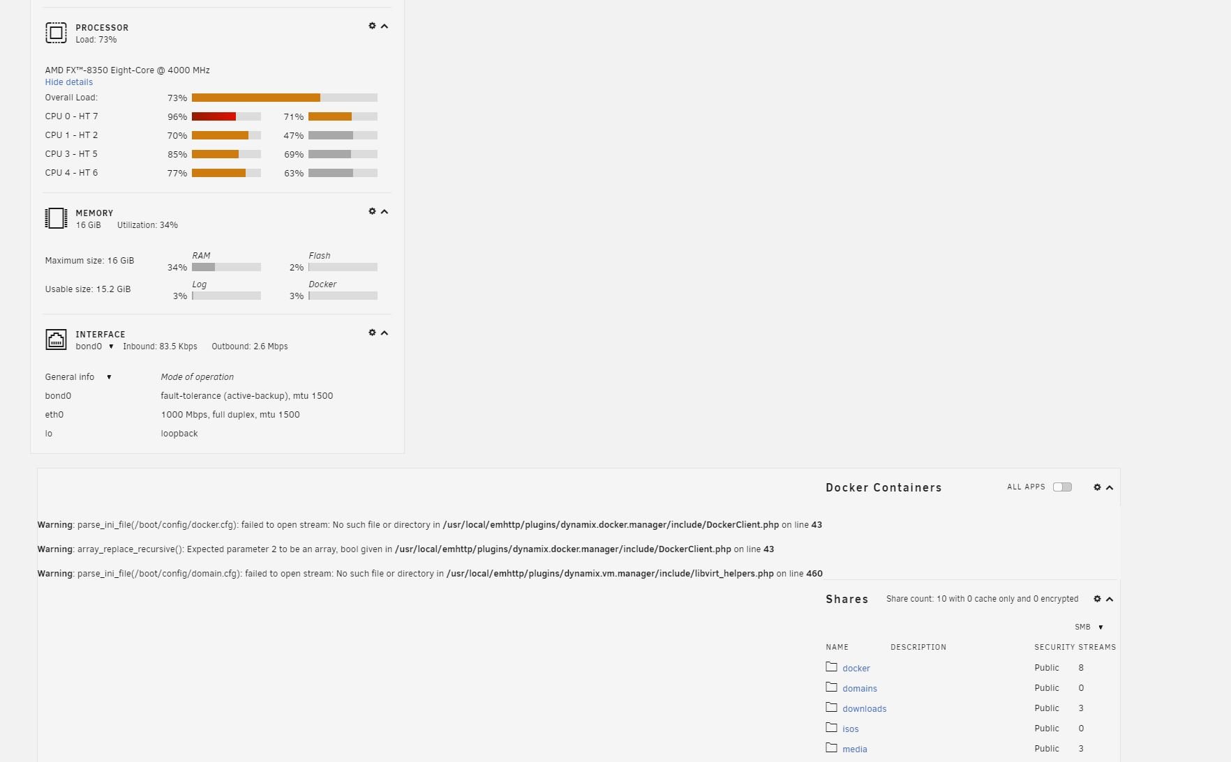

I have this error the pops up on Unraid now and do not know what to do about it. The server seems to be working fine, but I am worried this might lead to something worse.
Warning: parse_ini_file(/boot/config/docker.cfg): failed to open stream: No such file or directory in /usr/local/emhttp/plugins/dynamix.docker.manager/include/DockerClient.php on line 43
Warning: array_replace_recursive(): Expected parameter 2 to be an array, bool given in /usr/local/emhttp/plugins/dynamix.docker.manager/include/DockerClient.php on line 43
Warning: parse_ini_file(/boot/config/domain.cfg): failed to open stream: No such file or directory in /usr/local/emhttp/plugins/dynamix.vm.manager/include/libvirt_helpers.php on line 460
Thank you for any help!
One other thing, I recently lost my cache drive and had to redo all my dockers. This may have something to do with it.
Those errors more imply that the flash drive dropped offline or was removed
Thanks for the reply. That makes sense because the flash drive showed up in unassigned devices as able to mount. Any ideas how to fix that. A reboot sorted it this time.
*Usually*, it can be solved by simply using a USB2 port  Kinda depends if this was a one off (you jarred it eg), or if it repeats

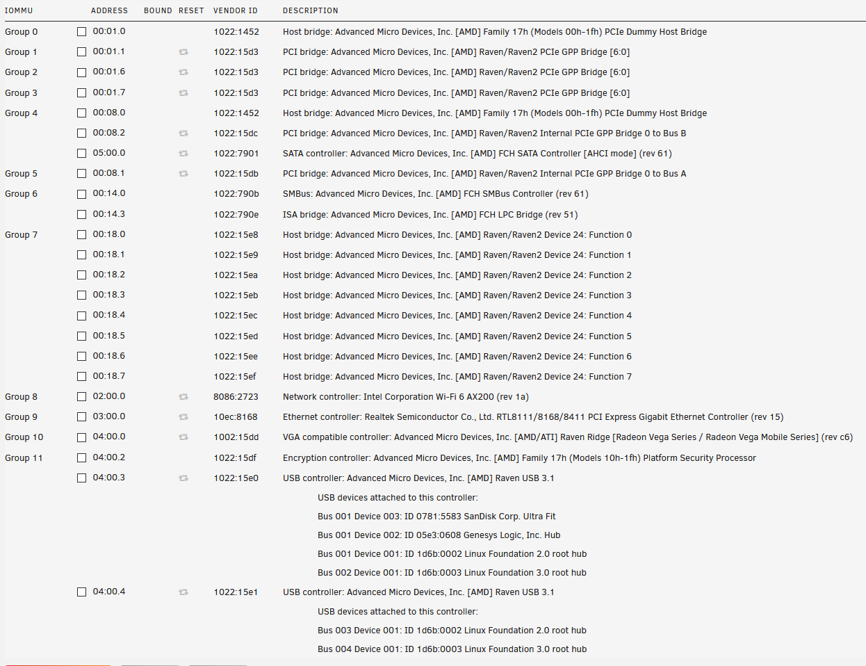

sorry for digging this topic out again but since the thread already exists, I'm using it 🙂 I also have the problem that my USB ports get killed when I select the igpu (Ryzen 2400G) as my graphics card and start the VM (Win 10). I've tried everything possible, but the problem just won't be solved. can i explicitly exclude certain iommu groups from using it so that virtualization doesn't even get the idea to use the usb ports? i have an usb 2.0 port on my Asrock Deskmini A300, but it is attached to the 3.1 controller shown in the picture. an usb 2.0 bracket for expanding the Deskmini is already on its way to me and i hope that it can be solved (hopefully an extra controller for the ports).
I could easily be wrong, as I don't have any AMD equipment, but I'm pretty sure only some generations of intel igpu's are compatible with passthrough to a VM. I'd be happy to be proven wrong, but from what I've seen AMD igpu passthrough isn't a thing at all for now.
i have here an old ASRock board with H87 chipset and an i5 4570. there igpu passthrough works fine, even without a second graphics card. but the whole thing is in ATX format, takes up space and twice the power in idle compared to the ryzen.. i got the deskmini very VERY cheap incl CPU and RAM and could not resist. if only the passthrough would not work OK, but that the USB ports are completely killed!? there is surely a solution for... but which one?!

Just to note here, this problem occured on my machine as I was preclearing one disk via USB on the neigbour port of the unraid usb stick.
