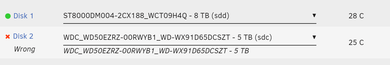

Hopefully you guys can help me out. I had WD 5tb drive connected via usb 3.0 that I moved files from and then did a pre-clear. Then without thinking about it I added it to my array ( I had intentions to put the drive internal to the server). So I stopped the array, pulled out the drive and then installed it into one of the hotswap bays on the server. The drive is recognized but it keeps telling me its the wrong disk even though it matches perfectly. (See screenshot) please tell me how i can fix this. (this is initial setup and I do not have a parity drive yet). I'm pretty new to unraid but so far i'm loving it (if i can fix this)

You may need to put it back the way it was before. Some USB - SATA interfaces alter how the drive is presented.
so i would have to put on the adapter, then remove it from the array, then remove it from usb, put internal, then re pre-clear/format? I haven' put data on that disk yet as the array was not used.

Okay, so new information. If i put the hard drive back on the usb adapter from the enclosure it recognizes the xfs filesystem and matches my array and everything will work as normal. So my next question is how to remove the usb drive from the array. (my array does not have parity yet) So i can then put it internal and clear/format/add back to the array?
Last one, sorry guys! I figured it all out. Figured I would post the solution here in case anyone else has the same issue.
I stopped the array, then went to Tools > New Config as suggested in first replay. This reset my array. Then I added the 8tb drive (the one with data on it) to the array along with my cache drive.
Then I put the usb drive inside the hot swap bay on the server, the filesystem wasn't recognized, then i did a format to xfs and I was able to add it to my array just fine.
So there was some sort of issue with the drive being plugged in via usb instead of mobo sata that unraid didn't like. Something must not match in the drive signatures or something. Which is a little odd as it seems unraid uses drive serial numbers and that didn't change.

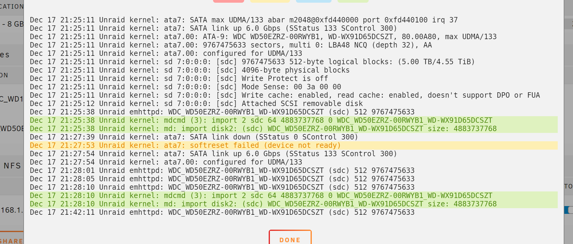

It is not just the serial number that must match.    The drive must also report itself as holding exactly the same number of bytes and the USB enclosure may have massaged that in some way.
