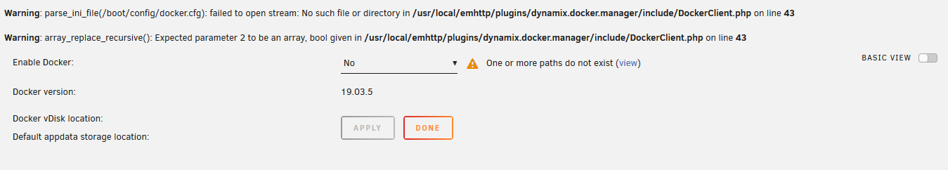

so I am trying to follow the extremely outdated how to video on how to start up my docker and then try and install plex, but I get this
so far I cant seem to dig up any information other than the referred to directories do not exist and I cannot seem to create then via command line.
I suspect you don't have any mountable disks yet.
Go to Tools - Diagnostics and attach the complete diagnostics zip file to your NEXT post.
Looks like a flash drive problem.
Put it in your PC and checkdisk. While there make a backup. Be sure to boot from a USB2 port.

Everything about your configuration is in the config folder on flash. As long as you have a current copy of that config folder you can use it on a new install and everything should work as before.
For future reference, you can always download a zipped copy of flash at Main - Boot Device - Flash - Flash Backup

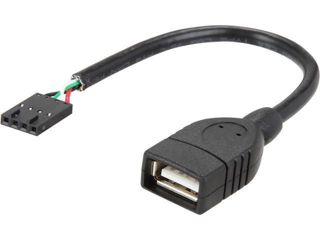

my motherboard doesnt have internal USB
I recommend getting an adapter.
