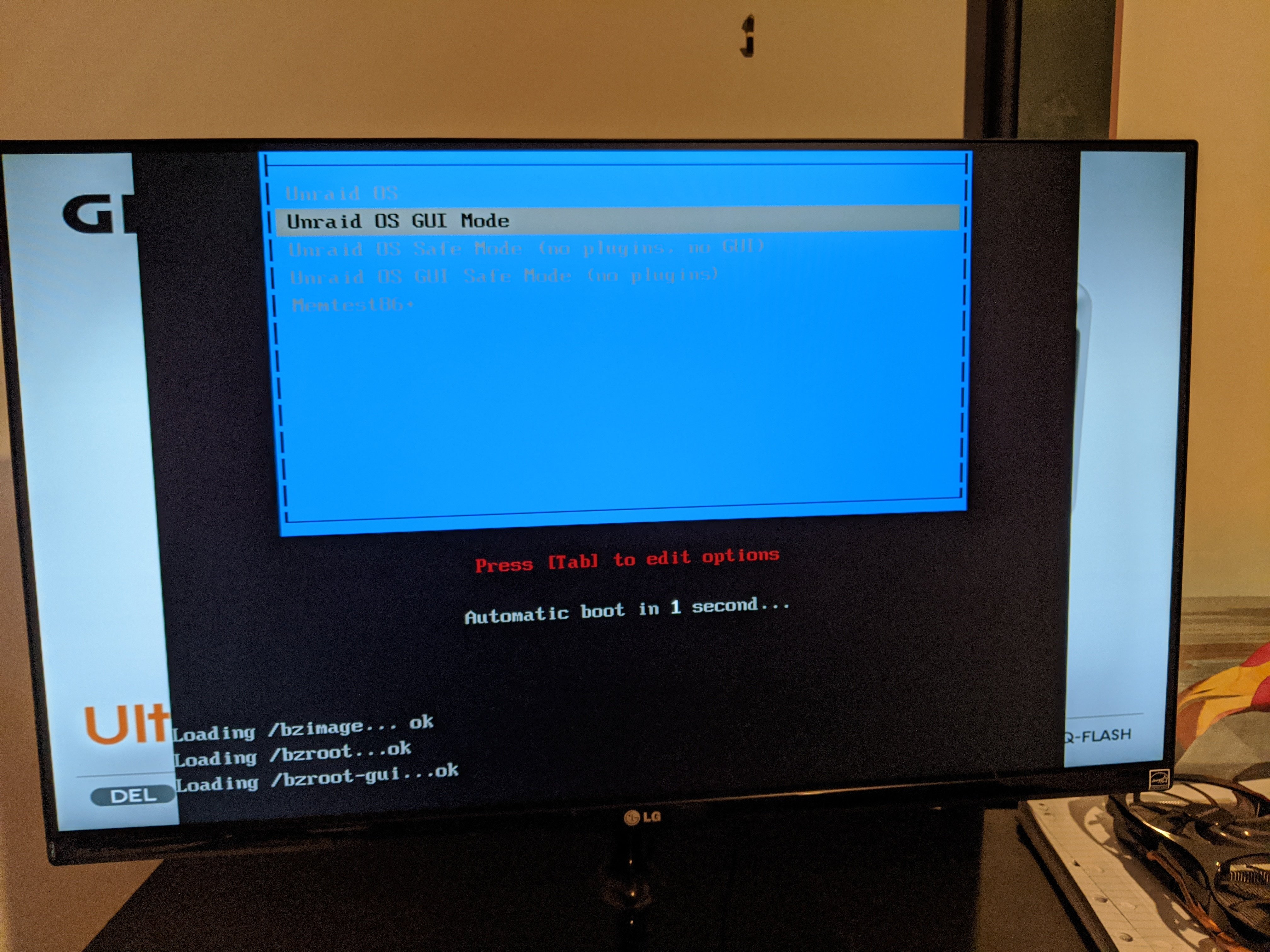

Thanks, that did the trick. Appreciate your help.
The screen looked weird on the next reboot; but at least I'm up and running again.
I still wish I knew what caused this and what will stop it happening again.
Thanks again.

In fact, I recommend you do that now to fix your messed up boot menu and who knows what else. Get a backup, prepare flash as a new install, restore the config folder from the backup.
