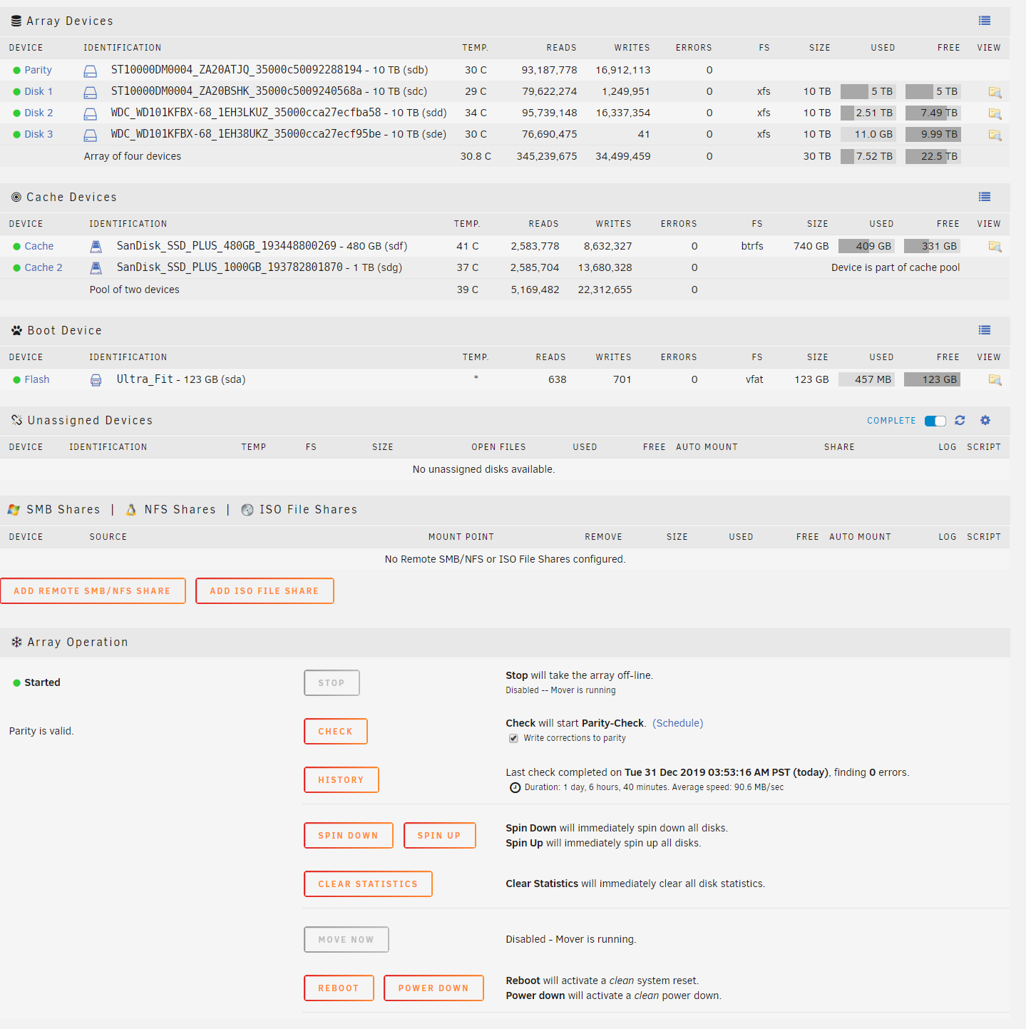

I have a typical Unraid setup with a few Dockers running. I left it last night with my LOG at 1% full, this morning its at 80% full. I had this happen once before where something was filling up my LOG but I have no idea what. Can someone help me make sense of this?
I tried to stop the two Dockers I was most concerned with (Sabnzdb and Plex), Sabnzdb stopped but Plex wont stop and it is currently giving me a write error 403 onto the Docker Image and I'm running a balance.

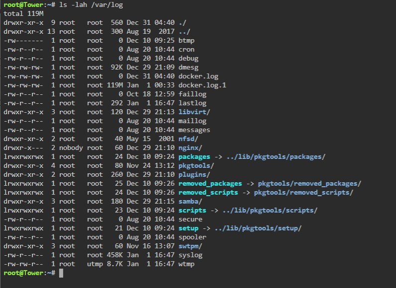

What do you get at the command line with this?
ls -lah /var/log
@trurl Here is the output of that command. It's clearly docker.log.1 that's eating all the space. I have no idea how to access that file to figure out what is causing the mess.

docker.log is all that gets into diagnostics so you would have to post that older docker.log.1
Sorry, newb question, how do I download the docker.log.1 file from the Unraid GUI or from terminal?
That's really too large to post even zipped I guess. Probably a lot of the same stuff over and over anyway. Might be better to start over by rebooting, and then later get diagnostics so we can get the new stuff from docker.log the usual way.
